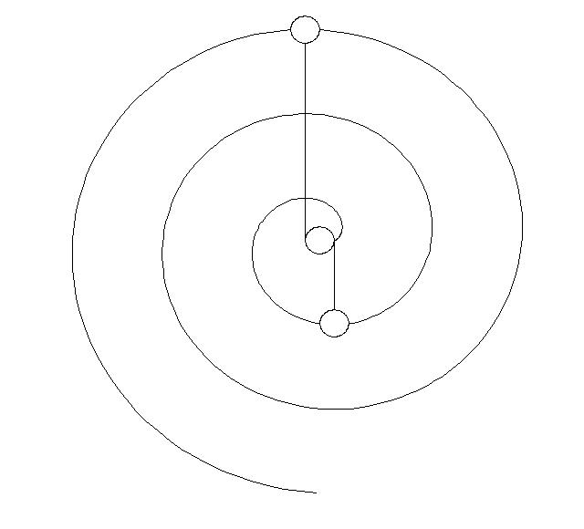

Again it depends on the direction of the force relative to the path of the object. If the force is kept perpendicular to the direction of the object at all times, such as the involute of circle path, then F and v remain perpendicular and the work done is zero. I'll include the image here of that path, note the string is always perpendicular to the path of the object (the center is a pole that the string winds aorund or unwinds from). The other issue here is what is really "radial" when the path is not a circle, such as a spiral, ellipse, parabola, hyperbola, ... ?
But in this spiral path the velocity is not perpendicular to the force. If it were there would not be a spiral path. It is close, but it is not exactly perpendicular and the deviation depends on the magnitude of the centripetal force compared to the current radius of the "orbit?"
It is exactly perpendicular, so the velocity changes direction, but the speed (magnitude of velocity) never changes (until impact with the pole). The equation for the normal line to the involute of circle is the same as the equation of the tangent line of the inner circle (pole). The math is shown in post #32 of this thread (direct link):
https://www.physicsforums.com/showpost.php?p=1435942&postcount=32
