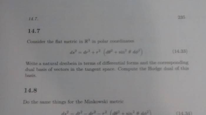

I have doubts about the next concepts in gravitation: Tetrads, dual basis, normal basis, standard basis, local basis, orthogonal basis, FIDO, FREFO, Frames, Diffeomorphisms, Affinne conection, etc.If I am not wrong, "frame" is a general concept of n-tuplets of vectors defining in a standard basis (standard basis is the basis on the tangent space, right?) $$ \partial x^{a} $$ for eveerypoint a tangent space. WE can then find the dual basis $$ dx $$ (how? just exchanging partials by exterior derivatives?) and a differential form instead the original vector (how to get it, again?) which both, defines a cotangent vector. The frames in Relativity are always with an orthonormal set of coordinates.
But I just read an exercise which aks for write an adequate dreibein of a metric in terms of differential forms and dual basis of vectors in the tangent space. Tangent space could be a mistake? I think should be cotangent space as is asking for dual.
I am still confused about the statement of that exercise. Could be a typo?
I don't know, you'd have to be more specific. You an maybe scan the page of the book that asks you this exercise?

Sorry for the low quality. My room has low brightness.
Ah, a driebein (although, before now I have never heard of such a term) is a triad...in other words a tetrad but in 3-D only. There is no typo in that problem statement. The tangent space is the space of vectors. The Co-tangent space is the space of one forms. They are dual to one another. Because the problem is asking you to first find the one-form basis, and then find the "dual" to those (which are vectors), then it is correct in asking you to find the "dual basis of vectors in the tangent space". Vectors live in the tangent space, not the co-tangent space.

I'm a little confused on why you are working on such an advanced problem when you obviously have some very fundamental issues you should understand first.
But the text is asking you to first compute a "natural" basis of 3 vectors which are ortho-normal, the dual one-form basis for this, and then the Hodge dual of the one-form basis forms...which will be a set of 3 2-forms in 3-D space. I think that is what the question is asking...
This is my first year with Gravitation subject and this is an exercise I must to for Monday.
Until today I only calculated dreibeins with the next form: e¹=dt ; e²= Rdθ and e³=rsinθdϕ for spherical coordinates so I am not sure about this exercise. What I used to do is defining the dreibein in natural basis, right? but how can I obtain the dual one-form basis for this?

The dual basis will be the the one which satisfies the following ##(e^\mu)_a (e_\nu)^a = \delta^\mu_{~\nu}## take into consideration the fact that ##(dx^\mu)_a(\partial_\nu)^a=\delta^\mu_{~\nu}## for a coordinate basis.
Hint: Since you have no terms like ##d\theta+d\phi## in your basis one-forms, it should not be too hard to figure out a dual vector basis.

You should be able to do this from inspection. For example, what is ##(dr)_a (\partial_r)^a##? Or what is ##(r d\theta)_a(\partial_\theta)^a##?
Matterwave said:
Use # instead of $ wraps.
1 and r?
Yes, so how would you modify them to give 1 and 1?
Times the inverse. However why we want to get 1?

I think I got it:
$$ e^1 = 1 \\
e^2 = R \\
e^3 = Rsin\theta d\phi
These are the dreibein in terms of differential forms with the dual basis of the vectors in the tangent space, right?
I had a little doubt about calc ## de^1##, ##de^2## and ##de^3##...
You don't calculate ##de^1##...##(e^1)_a## is already a one-form basis, you don't need to try to calculate it's exterior derivative. But I thought you already calculated the ##(e^i)_a## in your previous post? You even wrote down ##(e^1)_a = (dr)_a,~(e^2)_a=r(d\theta)_a,~(e^3)_a=r\sin\theta (d\phi)_a## in your notation?
