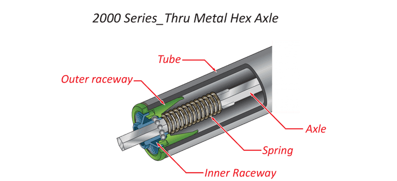

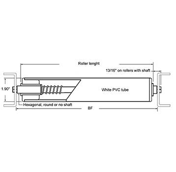

I just wanted some clarification on how these rollers worked. All you would technically need to do is to build the frame and attach these to the frame and motorize it correct? Do you still need to add a bearing to the sides? If you do, how would you because the axle length on each side is about half an inch if not less for other rollers? I'm basically confused on whether the hex axle on the side spins as well or does it stay stationary and the roller frame spins. Thanks, any clarification would be helpful
No extra bearings are required. There are two hex-bore bearings pressed into the ends of the roller. The hex axle rod passes through both of those bearings.

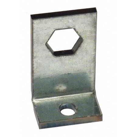

The hexagonal axle does NOT spin. The hexagonal end of the shaft rests in a narrow slot that you provide to prevent the shaft from turning. The inner races of the hex-bore bearings are also prevented from rotating. The outer races rotate with the roller.
A bearing failure will not cause the axle to rotate. It will lock that roller. That will prevent continuous axle rotation from damaging the support structure.
https://www.mcmaster.com/catalog/2277t413
See the column on the left for details of the ball bearings.
