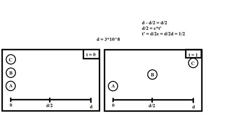

funnyman634
When I think of the speed of light being constant for all reference frames, I imagined the scenario in the picture below to exemplify it. Object A is always at rest, object B is moving at half the speed of light along the only given axis, and object C is a light particle moving at the speed of light along the only given axis. The objects are placed at different heights in the image only for visual clarity, so a 1D scenario. The frame on the left is t = 0 (say t is for object A and t' for object B) the objects are all at rest (I know object C can never be at rest if it's a light particle, but then let's just assume it comes into existence the moment the scenario begins). We start the simulation and then freeze it after a second has past, t = 1, the frame on the right. I solve for t' (the amount of time object B felt has passed) based on what has occurred. Why do I get 0.5 seconds and not what the Lorentz factor says I should get, 0.86602540378 seconds ? (1 / gamma or 1 / 1.15470053837925)
Where did you come up with ##d/2=ct’##? That isn’t right.
You should use the full Lorentz transform at first. Only use shortcuts once you understand the full transform.
You forgot distance contraction in B's rest frame. In this problem, as you've set it up, that's all you need to get the right answer.

I do not want to use the Lorentz transform, I want to see where my intuition goes, and then see why the intuition is wrong, and then alter the intuition and try again with only intuition.
##d/2## is the distance between B and C in A's frame after 1 second in A's frame. If we know in general that ##distanceTraveled = timePassed * velocity## and I know the distance between B and C to be ##0## when ##t = 0## and ##d/2## when ##t = 1## in A's frame, and I also assume ##c## is constant, why can't I setup the equation as shown, which shows ##t'## to be .5 after the algebra?

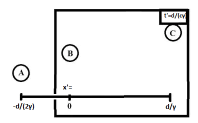

The simple answer is that you haven't transformed the scenario to the frame of B. You've done it only half-heartedly - keeping all your diagrams in A's frame; using measurements in A's frame; and, only grudgingly, given any consideration to what B might measure!
If I were B I might object that you have been very reluctant to abandon A's point of view! You're not looking at it sufficiently from B's point of view!

Because, per B, the event of B coinciding with the midpoint (d/2) in your diagram has involved A moving ##d/2\gamma## at a speed of c/2. This leads to a time of ##1/\gamma## for B. I already pointed out the omission of distance contraction in an earlier post, which you completely ignored.

That isn't how intuition works. Intuition works by doing something many times until you begin to mentally internalize it. Neural pathways are established through repetition, and serve as shortcuts so that things which required attention and effort become automated. Once you have internalized it, then the resulting experience becomes intuitive. You cannot start with intuition, intuition comes only from experience. That is why physics classes involve lots of practice problems. The purpose is to build that intuition since it cannot come first.
Your approach is doomed to fail. The correct approach is to
1) identify the events of interest with coordinates in the unprimed frame:
All objects together at the origin: ##\mathbf{O}=(t_O,x_O)=(0,0)##
Object A alone at the left: ##\mathbf A = (t_A,x_A)=(1,0)##
Object B alone at the middle: ##\mathbf B = (t_B,x_B) = (1,0.5)##
Light pulse C alone at the right: ##\mathbf C = (t_C,x_C) = (1,1)##
2) transform all events to the primed frame:
All objects together at the origin: ##\mathbf{O}=(t'_O,x'_O)=(0,0)##
Object A alone at the left: ##\mathbf A = (t'_A,x'_A)=(1.15,-0.577)##
Object B alone at the middle: ##\mathbf B = (t'_B,x'_B) = (0.866,0)##
Light pulse C alone at the right: ##\mathbf C = (t'_C,x'_C) = (0.577,0.577)##
So B's clock does indeed read 0.866, and according to B that is not the same time as the time when C reached the right end. According to B, light reached the end when B's clock read 0.577. The main problem with your intuition is that time ##t=1## in the unprimed frame is not any single ##t'## in the primed frame.
To get that type of intuition requires solving it right many times, and that requires a little mathematical rigor and a lot of repetition. Your current approach runs the risk of repeating something wrong, and thereby getting wrong intuition established. Any action, wrong or right, can be repeated until it becomes intuitive.

As an added point, it is easy to directly derive when, per B, C reaches position d in A's frame. One imagines a ruler of length d at rest with respect to A. Per B, it has length ##d/\gamma##, and is moving to the left at c/2. Meanwhile (by lightspeed invariance), C is moving to the right at c relative to B. Thus, the closing speed of C with respect to the ruler end (per B) is 1.5c. Computing ##(d/\gamma)/1.5c## gives ##2/3\gamma##, which agrees with what @Dale got via Lorentz transform. And, of course, this is well before the d/2 ruler mark reaches B, per B (which is ##1/\gamma##, by my prior argument)
[edit: Thus, combining my two arguments we derive that B arriving at d/2 and C arriving at d are not simultaneous per B, rather than using this fact in either argument.]
