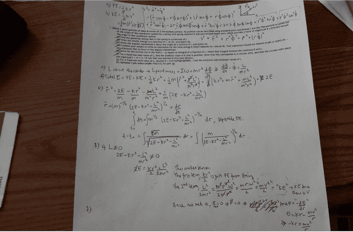

See "attempt..." below
part a. PE in this case is kr^2/2 (due to spring only)
part b. KE = mv^2/2, where v is r_dot^2+(r*phi_dot)^2, see attachment for how I derived this--I apologize for not being familiar with the formatting here!
L=Iw=mr^2w, w=d(phi)/dtheta
what I did: part c->solve for d(phi)/dtheta
part d->use d(phi)/dtheta from part c to replace the same thing in KE equation. Add KE and PE=Total E
part e-> solve for r_dot. Then make it into separable DE, solve the left side (integral dt=t-t_0) and it equals to a crazy right hand side below
part f->set 2E-k^r2-L^2/(m*r^2) to 0 because it can't be 0, or otherwise there is a problem. checked it and it llokd OK
(-----part g->(not sure part) set r_dot=0, solve for r, except I couldn't. I know that I should be getting 2 r values, but wolfram spits out imaginary answer. And I need to find r_dot_dot, plug in the r values. If positive=minima, negative=maxima (my plan, anyway)------)
I have work for part a-f, currently stuck in part g. And now I question my whole work.
(here is the link, just in case the picture doesn't show: http://i58.tinypic.com/30hlp1s.jpg)
Thank you very much in advance. Any enlightenment or confirmation if I am in the right direction or suggestion or advice would be very much appreciated.
Picture doesn't work, but at least the link works.
