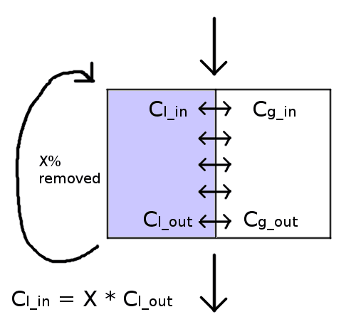

Hi all. I've been working on this for two days and I feel embarrassed that I haven't been able to figure it out. I'm dealing with the following cocurrent diffusion situation between an aqueous and gaseous flow moving at the same velocity:
X% of the liquid is removed and replaced with fresh (0% concentration) each runthrough, so the incoming liquid concentration C_l_in is X% of the outgoing liquid concentration C_l_out. The incoming gas concentration C_g_in is known. The diffusion constant and Henry's law constants are also known, as is the length of time the two are in contact, the total contact area, and the flow rates of both the liquid and gas phases
It seems this should be a common use case, but while I find tons of articles on Fick's Law and diffusion, all of my wading through them hasn't revealed any covering this case. And I've been trying to derive it on my own, but I suck at differential equations. :( Does anyone know how to solve for C_l_out and C_g_out?
(In case it matters: the above diagram is stylized; in practice it's droplets entrained in a gas stream)

Is the liquid solvent evaporating. Are you supposed to treat each phase as semi-infinite, or are you supposed to take into account the drop size? Please provide the exact statement of the problem. Your interpretation of the problem statement is not adequate to answer your question.
Thank you very much for your response.
The solvent is an ionic liquid and thus has negligible vapour pressure, and gases diffused into the droplets will not cause a relevant increase in their mass or volume; the area and volume can be taken as constant. Bulk temperature, pressure, density and velocity of the gas will also change little, enough to be negligible. However various partial pressures will change as diffusion occurs. The species of interest are primarily in ppm quantities. The bulk species will also diffuse into the liquid and quickly reach saturation, but their maximum solubility is limited.
The droplets are small enough and contact times are long enough that it would be fair to treat them as uniformly mixed. The gas however is not uniformly mixed. The flow is fairly close to laminar - fan driven, but by the time of liquid injection it has already passed through an electrostatic precipitator (hex grid of tubes), and thus has significantly reduced vorticity. The conduit is relatively straight and unobstructed (no packing - just mist collection at the end for recovery)

1. No, it is not a homework problem
2. The problem I've had with trying to solve it myself is that I end up with an iterative series of three equations representing how the state evolves from one timetstep to the next (those three being liquid phase concentration, average gas phase concentration, and mass transfer rate), but I can't seem to reduce them into a single integral or summation that I could solve. I could always "solve" it by writing a python program or whatnot to iterate over tiny timesteps and evolve the concentrations until they converge, but that's clearly not the "right" way to go about it (is it not?), and I couldn't insert that into my spreadsheet for automatic updates if I did it that way.
3. I'd like to be more precise but I'm not sure what you consider to be missing from the above. I can try rewording, if that would help.
"Liquid is injected into a gas stream forming droplets in a concurrent, largely laminar, constant velocity/temperature/density stream where gas can diffuse into the droplets . The droplets are represented as fixed mass/volume/surface area with a concentration that varies with time but not depth. The gas is represented as a fixed mass/volume flow with a concentration that varies with time and distance from the solid-liquid interface, to some finite distance (halfway to the next droplet). The two phases remain in contact for a fixed timeperiod. The concentration of the species in the liquid phase at inflow equals the concentration in the liquid phase at outflow times some percentage X (aka, X percent of the liquid is replaced with fresh). The inflow gas concentration is fixed. The diffusion coefficients are known. Solve for the gas and liquid concentrations at outflow."
Is that clearer wording? Just a concurrent scrubber - and what should be an easier case than most (aka, the liquid doesn't evaporate). But I can't find anything that addresses this specific problem anywhere. The information is almost certainly out there somewhere, but mixed in with a flood of pages describing other, inapplicable problems, which is how I ended up here.

The case where I got the furthest on was the simplified case, where diffusion through the gas was assumed to be instant (figuring once I solved that I could work on adding in diffusion through the gas as well). For it my equations were:
C_l(N+1) = C_l(N) + s * D_l(N) / F_l
C_g(N+1) = C_g(N+1) - s * K_l(N) / F_g
K_l(N + 1) = D_gl * A * (C_g(N)/H - C_l(N))
Where
C_l = concentration in liquid
C_g = concentration in gas
K_l = mass transfer rate from gas to liquid
s = timestep (infinitesimally small)
F_l = liquid flow rate
F_g = gas flow rate
D_gl = diffusion rate between the gas and liquid
A = total droplet surface area
H = Unitless Henry's law coefficient
(Hope I transcribed that right; I had actually been using cell numbers from my spreadsheet in my calculations)
I got no further than this because I was just grinding gears trying to turn those three equations that depend on each other into something I can solve. Ultimately, though, I also need to factor in diffusion through gas to the surface, and after t / s timesteps (aka, it's reached the outflow end, the gas is escaping and the liquid is being pumped back) C_g needs to be reset to its initial value and C_l needs to be multiplied by the percentage of liquid recycled, and the whole process run iteratively until it converges.
As mentioned, obviously I could do this by writing a program to iterate over tiny timesteps. But this strikes me as A) wrong, and B) slow / a pain for integrating into my spreadsheet.
The equation for the mass transfer rate is not correct. Let's try something a little different. You know the ratio of the volume of gas to the volume of drops. Suppose you had a single spherical drop, immersed in a surrounding spherical volume of gas, with the ratio of the volumes equal to the actual ratio of volumes. So you are treating this combination as a unit cell. Now all you need to do is quantify the time-dependent mass transfer behavior within the unit cell. Are we together so far?
Hmm, I took it from one of the pages I found. Perhaps I transcribed it wrong.
Yes, your example is perfectly reasonable. :)
OK. Here's what I get:
$$F_L\frac{dC_L}{dV}=\alpha \phi\tag{1}$$
$$F_G\frac{dC_G}{dV}=-\alpha \phi\tag{2}$$
where ##\alpha## is the mass transfer surface area per unit volume of the unit, V is the cumulative volume of the unit (up to a given location), and ##\phi## is the is the mass flux at the drop surface:
$$\phi=5\frac{D_L}{R}\left(\frac{C_{GI}}{H}-C_L\right)=\frac{D_G}{R}(C_G-C_{GI})\tag{3}$$
where ##D_L## is the diffusion coefficient in the liquid, ##D_G## is the diffusion coefficient in the gas, ##C_{GI}## is the gas concentration at the drop interface, and R is the radius of a drop. From Eqn. 3, it follows that:
$$\phi=\frac{(C_G/H-C_L)}{R\left[\frac{1}{5D_L}+\frac{1}{D_GH}\right]}\tag{4}$$
I think I'll stop here for now.
Continuation of previous post:
If the total volumetric flow rate of gas plus drops is F and the volume fraction of drops is f, then Eqns. 1 and 2 can be rewritten as:
$$f\frac{dC_L}{dt}=\alpha \phi\tag{5}$$
$$(1-f)\frac{dC_G}{dt}=-\alpha \phi\tag{6}$$where t is the cumulative residence time (t = V/F). If we add equation 5 and 6, we find that $$fC_L+(1-f)C_G=fC_{F0}+(1-f)C_{G0}\tag{7}$$
Combining Eqns. 4 and 5 with Eqn. 6 yields:
$$\frac{dC_L}{dt}=\frac{\alpha}{f} \frac{(C_G/H-C_L)}{R\left[\frac{1}{5D_L}+\frac{1}{D_GH}\right]}\tag{8}$$
$$\frac{dC_G}{dt}=-\frac{\alpha}{(1-f)} \frac{(C_G/H-C_L)}{R\left[\frac{1}{5D_L}+\frac{1}{D_GH}\right]}\tag{9}$$
If we now divide Eqn. 9 by H and subtract Eqn. 8, we obtain:
$$\frac{d(C_G/H-C_L)}{dt}=-\alpha \frac{\left[\frac{1}{f}+\frac{1}{(1-f)H}\right]}{R\left[\frac{1}{5D_L}+\frac{1}{D_GH}\right]}(C_G/H-C_L)\tag{10}$$
Eqn. 10 is the same as
$$\frac{d\ln{(C_G/H-C_L)}}{dt}=-\alpha \frac{\left[\frac{1}{f}+\frac{1}{(1-f)H}\right]}{R\left[\frac{1}{5D_L}+\frac{1}{D_GH}\right]}\tag{11}$$
The drop radius R in equation 11 is related to the volume fraction of drops f and the surface area per unit volume ##\alpha## by the equations:
$$4\pi R^2 n=\alpha\tag{12}$$
$$\frac{4}{3}\pi R^3 n=f\tag{13}$$where n is the number of drops per unit volume. If we divide Eqn. 13 by Eqn. 12, we obtain:
$$R=\frac{3f}{\alpha}\tag{14}$$Substitution of Eqn. 14 into Eqn. 11 then yields:
$$\frac{d\ln{(C_G/H-C_L)}}{dt}=- \frac{\alpha^2\left[\frac{1}{f}+\frac{1}{(1-f)H}\right]}{3f\left[\frac{1}{5D_L}+\frac{1}{D_GH}\right]}\tag{15}$$

This simplifies with the addition of temporary variables to:
r = -(H * D_G) / (H * D_G + 5 * D_L)
q = H * e^(1/3 * a² * D_G * t * (H*r/f² + H/f² + r/(1 - f) - r/f + 1/(1 - f) + 1/f))
C_L = q * (1 - f) + f * C_G0 - f * C_F0 - C_G0)/(f * H - f - H)
Treating t as t_final and setting C_F0 equal to X% of that value, I get:
C_F0 = X * q * (1 - f) + f * C_G0 - f * C_F0 - C_G0)/(f * H - f - H)
Which solves to:
C_F0 = X * q - f * q + f * C_G0 - C_G0) / (f*H - f - H + X*f)
From this, C_L_final and C_G_final can be solved.
Does this look right?

KarenRei said:
If I've solved this right. then all that's left is for you to explain what you meant in post #13 :)
I'll provide a write-up on the derivation of Eqn. 3 in the next couple of days.
Hmm, you're right - I did integrate incorrectly (only with respect to time). I'll start instead with your equations 16-17:
$$C_G/H-C_L=(C_{G0}/H-C_{L0})\exp{(-t/\tau)}\tag{16}$$where
$$\tau=\frac{3f\left[\frac{1}{5D_L}+\frac{1}{D_GH}\right]}{\alpha^2\left[\frac{1}{f}+\frac{1}{(1-f)H}\right]}\tag{17}$$
... and as before put Eq. 7 in terms of C_G (I'll correct "C_F0" to "C_L0" for consistency):
$$C_G=\frac{fC_{L0}+(1-f)C_{G0}-fC_L}{1-f}\tag{18}$$
I substitute equation 18 into equation 16:
$$\frac{fC_{L0}+(1-f)C_{G0}-fC_L}{(1-f)H}-C_L=(C_{G0}/H-C_{L0})\exp{(-t/\tau)}\tag{19}$$
Now I need to solve for ##C_L##; it's shorter with your recommended usage of a temporary variable (τ), so I'll do this by hand. I'll represent it as a function over time.
$$C_L(t) = \frac{\frac{fC_{L0}}{1-f}+C_{G0}+(HC_{L0}-C_{G0})\exp{(-t/\tau)}}{\frac{f}{1-f} + H}\tag{20}$$
I verify the previous result by using Wolfram and then proceeding to simplify their result to mine.
Setting t to ##t_{final}## and setting ##C_{F0}## equal to X% of that value, I get:
$$C_{L0} = X\frac{\frac{fC_{L0}}{1-f}+C_{G0}+(HC_{L0}-C_{G0})\exp{(-t_{final}/\tau)}}{\frac{f}{1-f} + H}\tag{21}$$
Which solves to:
$$C_{L0} = \frac{C_{GO}X(1-\exp{(-t_{final}/\tau)}}{\frac{f}{1-f}(1-X) + H(1-X\exp{(-t_{final}/\tau)})}\tag{22}$$
Also verified by matching up my hand calcs to Wolfram.
So that all looks good. :) Take your time with your response about Eqn 3. Assuming I've done this correct, I can go ahead and start integrating this into my spreadsheet (I can change things if your comments about Eqn. 3 alter anything, such as the diffusion coefficients)
And again - my great appreciation for your help!

Hmm, this is strange. I'm working with the numbers in the spreadsheet, and concerning tau:
If we break that down:
$$3f$$
... is 3 times a small number, a fraction of a percent. Starting small (since that's ideal for me) at, say 0.04%, 3f equals 1.2e-3
$$\frac{1}{5D_L}+\frac{1}{D_GH}$$
... if we just haphazardly pick, say, the diffusion rates of CO2 in air (~1,4e-5 m²/s) and in water (~1,9e-9 m²/s), with the Henry's Law coefficient for CO2 in water (8.3e-1), the result is around 1e8
So the numerator is 1.2e5. As for the denominator, the right hand side is:
$$\frac{1}{f}+\frac{1}{(1-f)H}$$
That's 2,5e3. All that's left is the area. For a 10 micron mist at 0,13 m³/s , the surface area is 7,8e4m². Which we then proceed to square (6,08e9) and put on the denominator. So we have a huge 1.52e13 on the denominator(!). This dwarfs the numerator, leading to a tiny tau, which means that in my sample 2 second exposure, ##\exp(-t/\tau)## is such a small number that my spreadsheet simply writes "0" even though it's in scientific notation mode.
Okay, let's go with a larger mist - 100 micron. Surface area is now 7,8e3 m². ##\exp(-t/\tau)## is still so small that the spreadsheet can't display it in scientific notation.
Okay, let's go with a very coarse 1mm mist. Surface area is now 7,8e2 m². ##\exp(-t/\tau)## is still too small for scientific notation.
Okay, let's go with drops a whole centimeter across.. Surface area is now 78 m². Finally the spreadsheet can display ##\exp(-t/\tau)## in scientific notation: 2.88E-128. That can't be right, can it? To get ##\exp(-t/\tau)## down to equal 0.5 I have to drop the time to under 5 milliseconds. Isn't that... an unusually small figure for centimeter-sized drops?
ED: minor edit to the above. We're using a Henry's constant that's gas over liquid, not liquid over gas like the above that I quoted for CO2. But it makes no material difference since the value is so close to 1 - I just need to make sure I handle it right in the spreadsheet.
