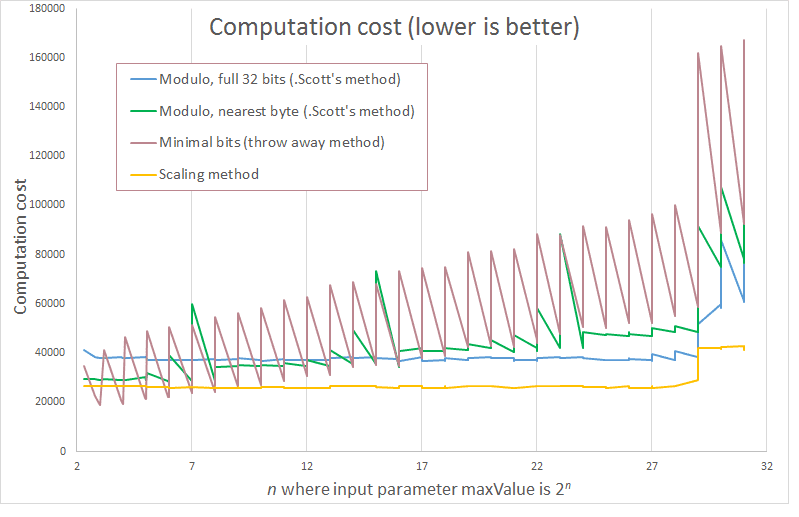

I have an update!
I've coded up and tested various methods. Since I'm using Microsoft's free version of Visual Studio, I don't have access to fancy profiling tools. But I did some rough profiling by timing how long it takes to perform long operations. Here are the results.
Note that the horizontal axis is not the actual input parameter, but rather n where the input parameter, maxValue, is 2n. In other words, the x-axis actually represents the input parameter maxValue as it varies from 0 to 4294967295 (and shown on a logarithmic scale).
Operations were done using a 32-bit data type. (Yes, I know the original post specified a 64-bit data type, and we've been doing examples with much smaller data types, but I figured 32-bit data type is a pretty good place to start taking data.)
[Edit: I'm not sure why there is a large jump in cost toward the end. It might be because I got home before the test was finished and watched an episode of Star Trek on the same computer running the test. But I'm not sure if that's the cause. The computer has several cores, and the test program only has one thread. So I don't know.]
Here is a summary of the algorithms.
Minimal Bits (throw away method) ______________
This is essentially my original approach, modified only such that masking is eliminated and only the minimum number of random bits are loaded that are necessary to represent maxValue - 1 and smaller numbers. This method uses the smallest amount of bits up front, but has a higher probability of having to throw them away, if the set of random bits corresponds to a number ≥ maxValue.
Advantages:
o Best approach available for many, relatively small values of maxValue.
Disadvantages:
o Not efficient for moderate to larger values of maxValue.
o Blows chunks if maxValue is slightly higher than a power of 2.
o Highest amount of overhead, involving shifting numbers around, sometimes on a bit-wise basis.
Modulo, nearest byte (.Scott's method) ______________
This is the approach that was essentially introduced by .Scott in post #16. Random bits are loaded in chunks of bytes. The number of bytes loaded are the minimum number that can represent maxValue - 1. Then a modulo operation is performed. This approach uses a larger number of bits up front, but has a smaller probability of having to throw them away (random bits are thrown away only if they correspond to a number greater than {the largest integer multiple of maxValue} minus 1, that can be represented by the loaded bytes).
Advantages:
o Performs very well overall, particularly with smaller values of maxValue.
Disadvantates:
o Moderate overhead.
o Performs relatively poorly if maxValue is smaller than a multiple of one byte, but larger than 1/2 that.; i.e., if 128 (0x0000080) < maxValue < 256 (0x00000100), 32768 (0x00008000) < maxValue < 65536 (0x00010000), and 8388608 (0x00800000) < maxValue < 16777216 (0x01000000).
Modulo, full 32 bits (.Scott's method). ______________
This is the same as above, except that a full 32 bit random number is initially loaded in, regardless of how large the input parameter maxValue happens to be. After that though, the algorithm is identical to that described above.
Advantages:
o Performs very well for larger values of maxValue.
o Low overhead, in terms of shifting numbers around.
Disadvantages:
o Performs relatively poorly for most smaller values of maxValue.
Scaling method. ______________
This is the
[tex]\mathrm{returned \ value} = \mathrm{(32 \ bit \ random \ number)} \left( \frac{\mathrm{maxValue}}{2^{32}} \right).[/tex]
approach.
Advantages:
o Superior computational performance for moderate to large values of maxValue.
o Simple, and straightforward implementation, with almost no overhead in terms of shifting numbers around.
Disadvantages:
o Due to rounding errors, produces results that are biased toward certain numbers. This effect is arguably negligible when using 32 bit datatypes as done here, but would be significant if smaller data types were used.
o Not the most efficient for small values of maxValue, since it uses an entire 32 bit word of data every call.
o Does not meet the criteria of the original post, but is shown anyway for comparison.
