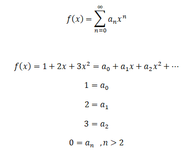

Say I express f(x) as a power series, and f(x) = 1+2x+3x^2 , so, I can match the coefficients as in the following picture:
( no problem there, since the series is a polynomial)

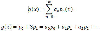

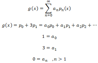

Ok..but what If I now have some function g(x) and I express it as Legendre series (in the x domain: -1 to 1 ) , and I know that
, where the p's are Legendre polynomials. :

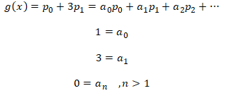

My question is , can I apply coefficient matching here? ( as in the next picture: )

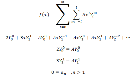

Also, consider the next case:
suppose I have :
, where the Y's are spherical harmonics... and I decide to show 'h' as a series such as this:
then, matching coefficients I get:
Eventually, I get a contradiction , on the one hand : A=2 , on the other hand A=3 , so my understanding of coefficient matching in this part is clearly wrong ( because it aint a series representing polynomials? )... why?
Yes, the Legendre polynomials are linearly independent.
You have different ##A## for each combination of ##\ell## and ##m##. The spherical harmonics are linearly independent.
