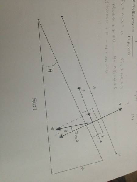

Hi tiny Tim! Here's what this is all pertaining to and some of my work:
Free-body diagram of a block on an inclined plane at angle θ, showing weight W, component W cos θ perpendicular to the slope, friction f, normal force N, and applied force F along the slope, with x and y axes.

how did you measure the force (or the acceleration)? :confused:
(and your equations are difficult to read … can you please type them out for us?)

I am confused as to what you are doing. To get a good understanding of what is happening I think you should draw a free body diagram of the block on the incline. You should get something like..
F = (mu)mgcos(theta) - mgsin(theta) where F is the force to move at a constant speed, and go from there.

but the 0.2 etc are one of the forces in your force equation
your force equation should add all the forces together to get zero (along the slope), including the 0.2
