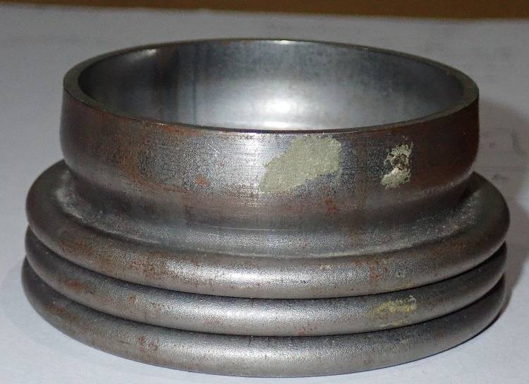

Collapse how? Lengthwise like this:
This is Castigliano buckling. There are other types of longitudinal buckling, for which I don't remember the names. Step on an empty beverage can for an example. The type of buckling depends on tube diameter, wall thickness, material properties, and end conditions. Each type needs a different equation.
Or, are you talking about the buckling of an externally pressurized tube? If so, look carefully at the origin of the formula. Does it assume that the tubing is perfectly round? Real tubing is at least a little out of round, and that has a large effect on buckling under external pressure.
