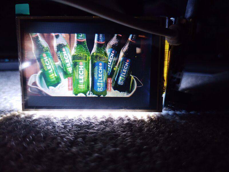

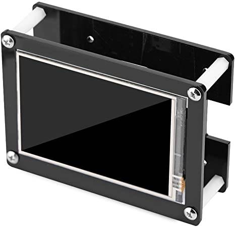

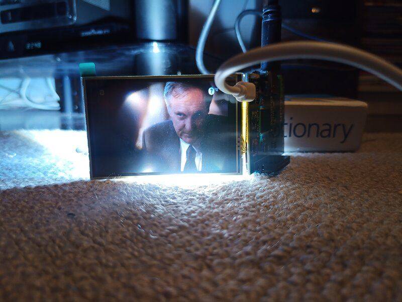

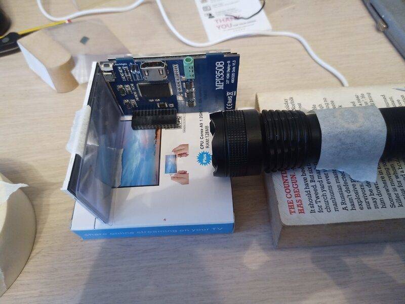

So I got a 3.5" raspberry hdmi LCD display.
And a bright LED torch.
I stripped the display, removed original backlight together with wedge light guide, then I removed white dispersing film, still from rear, and then again, underneath was another film, looking like kind of Fresnel lens, which I removed as well.
In theory, this should leave me with an LCD panel that has horizontal filter on the back, LCD matrix in the middle, and vertical filter on front.
Then I connected random signal (from my satellite box), power, and put torch behind it.
It's even darker than on its original backlight.
What am I doing wrong?

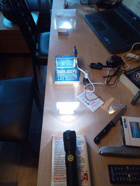

I'm getting suspicion that I'm actually doing it right..
Need to make an adjustable test rig.
Light holder (led stripped off that torch, maybe with its lens, maybe without), lens holder, screen holdr, another lens holder (may be needed), reflector/combiner.
Need to calculate curvature of that combiner, too, and blow mould (as opposed to vacuum mould) piece of perspex, so I end up with some 5-7 inch image on combiner, from a 3.5 inch screen.
And some light shield.
You are removing way too much of the illumination optics. Keep everything assembled except the light source, which you then replace with a high intensity source.
Getting that appropriately designed and implemented will likely keep you busy for awhile.
Cheers,
Tom

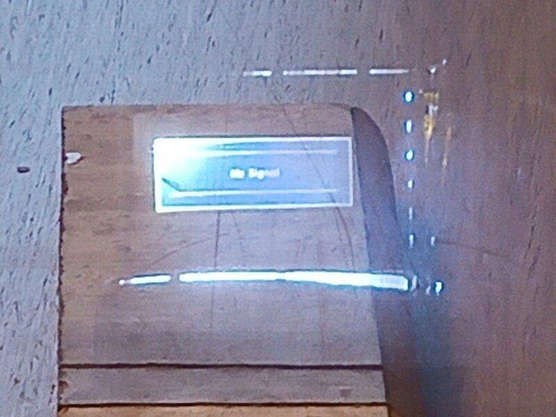

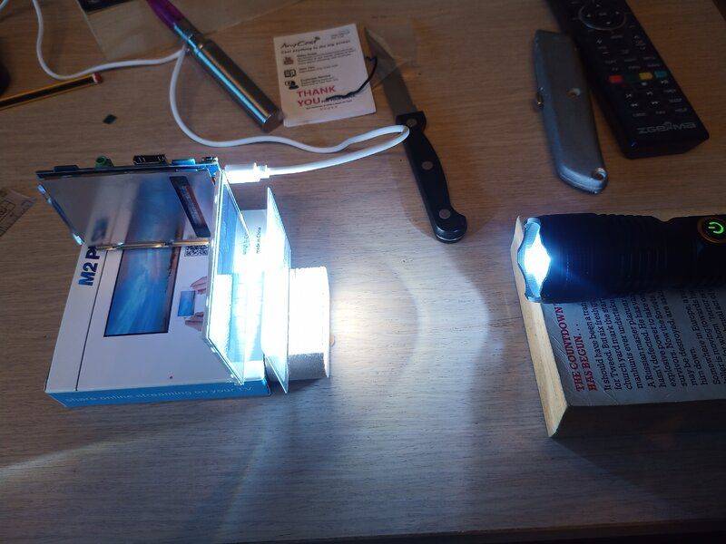

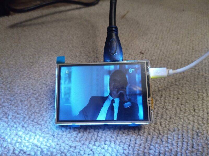

Actually.. I had it in the "bench" yesterday again
I didn't remove enough.
There was one more layer of adispersing film.
Now I got it working
Next step, make it shorter.

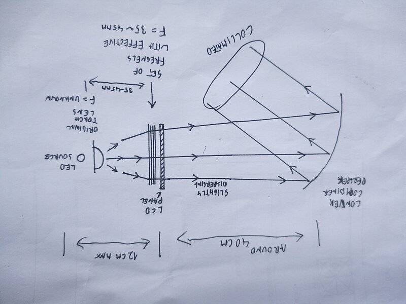

I collimate light just before it hits the LCD, currently I have a 180mm Fresnel lens, I need something around 35-45mm to be able to make unit short. Otherwise it will take too much space on windscreen and will be absolutely illegal.
Or I'll just use few 180mm lenses.
Need to prove it practically, but it looks like I don't need to worry much about light aberration.
It passes LCD as last step before hitting combiner, there's no lens to aberrate it between these two.

Here's what I'm trying to do.
