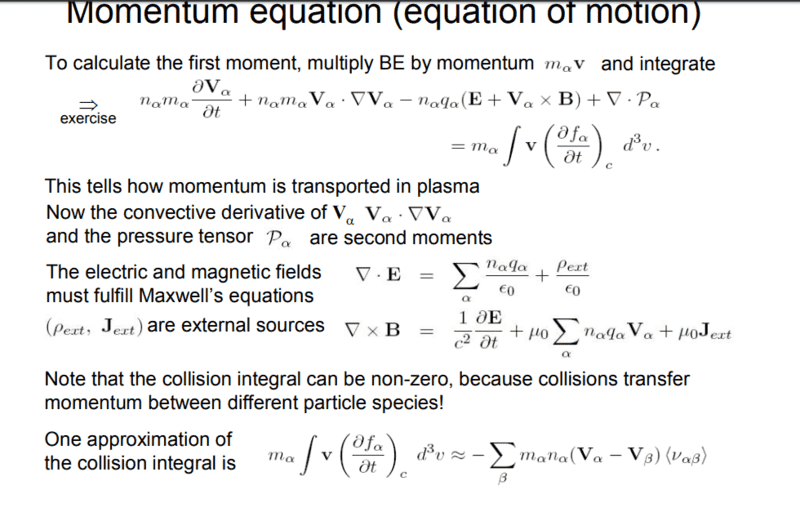

Hi, as you can see at the end of the picture/attached file collision integral is approximated to a discrete sum. Could you express how this approximation is derived?

It is not really an approximation of the integral from a purely mathematical point-of-view I think, it rather seems a mather of intuitive common sense.
It is reasonable to suppose that the velocity change of component alpha depends linearly on the differences with the velocities of the other components beta. I don't think there is much more in it than that.

mertcan said:
@thephystudent , I cut my attachment off that link https://courses.physics.ucsd.edu/2015/Fall/physics210b/LECTURES/CH05.pdf and page 10, so is it the right equation for collision integral for you? by the way why difference of velocity takes place in that equation?
Seems related indeed, where the $\langle \nu_{\alpha\beta}$ coefficient captures the average of some remaining coefficients. Difference of velocities= the relative velocity of particle beta when traveling along particle alpha.
thanks for responses but, I need some mathematical demonstration to learn better, could you help me about where relative velocity comes from that?
