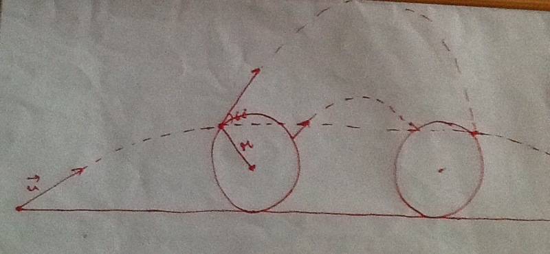

1. Homework Statement
a point mass is projected at an angle of 60° from the horizontal. it collides with the sphere at a maximum height of trajectory with a sphere of radius of 72.5cm such that it is projected off the sphere once again at an angle of 60° from the horizontal.The sphere, due to the collision, is bounced off the floor. The point mass, in its descent, collides with the sphere again, through the same horizontal of the previous point-mass-sphere collision, and is projected at an angle of 30° below the horizontal . if the density of the sphere is 50kg/m3 and uniform mass distribution then the mass of point mass,m and the initial velocity of the point mass is u. find floor(m + u) . Assume all the collisions are elastic, and the sphere is rigid.
mvi = mvfinal
xf = xo + vot + 0.5 a t2
couldn't try because i don't know why does the sphere bounces
someone please tell me why does the sphere bounce then i could probably start as in i know it is because the mass hit it but what exactly is the reason?[/B]

Is there a basis for your assumption that point mass hits the ball at the very moment the ball hits the ground again ? (In other words: did you render the complete problem statement ?)
i did that because the sphere only bounced one time according to the picture
vishnu 73 said:
ooh so that isn't the case?because if it didn't the ball would keep bouncing until it hits the mass
I don't know if that is the case or not -- still trying to formulate a complete problem statement.
Is THAT picture in post #1 an original part of the problem statement ? Or did you sketch it yourself ?
Goodness ! They target a brilliant audience, but their illustrating skills are rather limited -- and adding a mass and a velocity is close to complete heresy to ordinary physicists like me ?:) .
But now I understand your assumption and I agree.

ok this is all i got after this i am stuck i need help! this problem is driving me crazy
mu2 = mh2 + MV2 ---1
mu = mh + 2MVx ---2
hsin60 = Vy ----3
V2 = Vx2 + Vy2
hence since M = m
u2 = h2 + V2
u2 = h2 + (u2 + 4h2 - 2uh)/4M
EDIT: i need one more equation
wait you need to include rotational motion that is going to make the problem so much more harder !
and when i mean total momentum in y to be zero i mean right after the collision before hitting the ground. after hitting the ground the velocity in y will just become negative as before and x-velocity remains unchanged
I am inclined to dismiss this question.
The m+u in the target makes no sense unless it is specified what units m and u are to be expressed in. Asking for m+u is anyway bizarre. If it is possible to find that then it is possible to find m and u separately. (The same need not be true if asked for mu.). So why not ask for m and u?
In terms of m and u, we know everything about the initial impact: the velocity, location and angle of incidence. (You can use u and the launch angle to find the height of the impact.). Thereafter, we can know the position of each body in terms of m, u and t. That they should come together in that specific relationship at the same moment that the sphere hits the ground again gives three equations, so in principle we can find m, u and t.
It is not possible to use the final piece of information, the angle of m's path after second impact, without making some assumption about whether the ball bounces just before or just after the second impact with m. Either way, it now makes the problem overspecified. It almost certainly will lead to a contradiction.
sir @haruspex me and @BvU believe mass of point mass and ball are the same if you may please take a look at my calculations in post #6 and tell us if we are correct thanks
and i so far only managed to get 3 equations namely momentum in x and momentum in y after first collision and finally conservation energy all these three collectively could only eliminate one variable please tell me what is the other equation i need to use

Yes,you make a useful argument that since the flight times are the same they must have the same vertical velocity after the first collision (and the ball's immediate bounce). But that means the top of the ball is always higher than the mass, so the trajectories described in the problem are not physically possible.

You could overlook the physical impossibility and pretend that the mass can magically pass through the sphere until the second impact.
BvU said:
until I'm convinced otherwise.
Since the flight times are the same, the vertical velocities after the first impact must have the same magnitude.
Since the mass m strikes horizontally, the vertical momenta must have the same magnitude.
Ergo, the masses are the same.
I'm convinced. This makes the exercise physically despicable and the accompanying picture (purposely?) misleading. It's a mathematical figment of imagination -- and yet I'm still curious to know the trick hidden deep inside there. Almost enough to join 'Brilliant' to find out ... :smile:

As already deduced, the two masses are the same and they have equal and opposite vertical velocity components immediately after first impact.
When two equal masses collide elastically, the velocity components normal to the plane of contact simply swap over. The point mass therefore comes to rest in that direction, moving off tangentially to the sphere. Since that is 60 degrees above the horizontal, the line of centres must be 30 degrees below it.
It follows from the above that the sphere acquires a greater horizontal velocity than the point mass retains. It is therefore impossible for the point mass to overtake the sphere in the manner of the diagram.
Perhaps treating it as two collisions, point mass with sphere then sphere with ground, is wrong.
