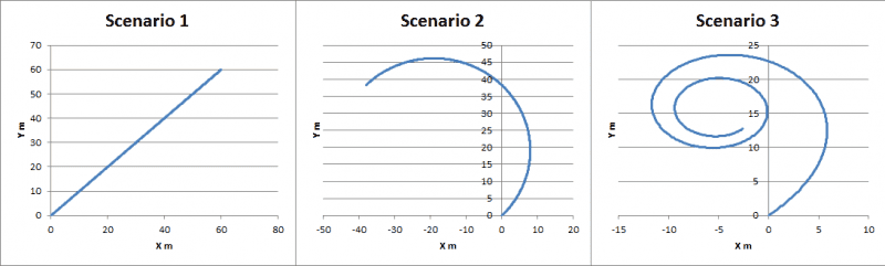

I'll try an illustration to help explain what I'm trying to do.
In all three scenarios above I have plotted the position over 60 s starting from (0, 0) with an initial orientation along the x-axis and no linear acceleration (in the body's axes).
In Scenario 1, I have an initial velocity of (1, 1) m/s, and no rotational velocity or acceleration.
In Scenario 2, I have also introduced an initial angular velocity of π/60 rad/s. The velocity remains as (1, 1) m/s relative to the body, but as the body's orientation is changing, it traces an arc.
In Scenario 3, I have also introduced an angular acceleration of π/600 rad/s², which then causes it to spiral.
I would like to know, given a constant acceleration in the body's axes, how do I calculate its position and velocity in the fixed axes at any given time?

The linear velocity relative to the body's axes? Linear velocity of what? You mean a specific point of the body?
Using the body's axes is tricky. You consider these axes as moving with the body? Or fixed? Or moving but only by translation?
Ok but that's not how physical objects behave in the real world. Bodies have momentum so simply rotating them does not alter the direction component of their velocity. For that you need an acceleration.
Edit: If you throw a ball straight up it will go straight up regardless of any spin you give it.
Something is unclear here.
You assume that the points of the body move relative to the body? Isn't this a rigid body?
or put it this way... You say...
How can a body can have a velocity relative to itself?
Perhaps look up centripetal acceleration. If the object moves in a circle that implies it's being accelerated towards the centre of the circle eg at right angles to it's instantaneous direction of motion. It doesn't have velocity in that direction.

Yes, the axes are moving with the body, following its orientation.
It produces its own thrust, more like a rocket than a ball, so it should move in a different direction as it spins.
That makes more sense. To move in a circle start with some initial velocity (v) and generate a sideways thrust (force) perpendicular to v (eg pointed at the centre of the circle). This will generate centripetal acceleration. The required force = mv2/r where m=mass of object, v = velocity, r = radius.
However this assumes you are modelling mass and inertia correctly. I suspect you might not be.
