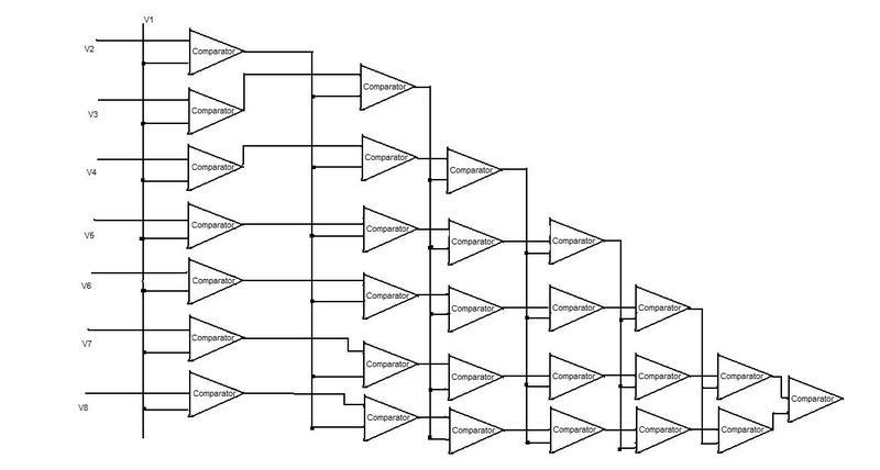

I drew a circuit using paint for this function. I was wondering what kind of individual comparator should I use to save the most power.
Also, what are some less noob ways of going about this?
sorry if stupid question. I am an undergrad

Comparators give a high output if one input is higher than the other, and a low output if they are the other way around.
They don't pass one of the inputs through to the output. You either get 5 volts or nothing (if "high" is 5 volts)
There are analog switches (like the 4066) which allow analog signals to pass through if a control input is high but stop signals if the control input is low.
Realistically, you should do this with a micro like a Picaxe chip or an Arduino.
You could read the inputs with the A to D converters of the micro and output a 5 volt control signal on an output pin which then switches an analog switch to let that signal through to the output.

Thanks! that helped a lot
