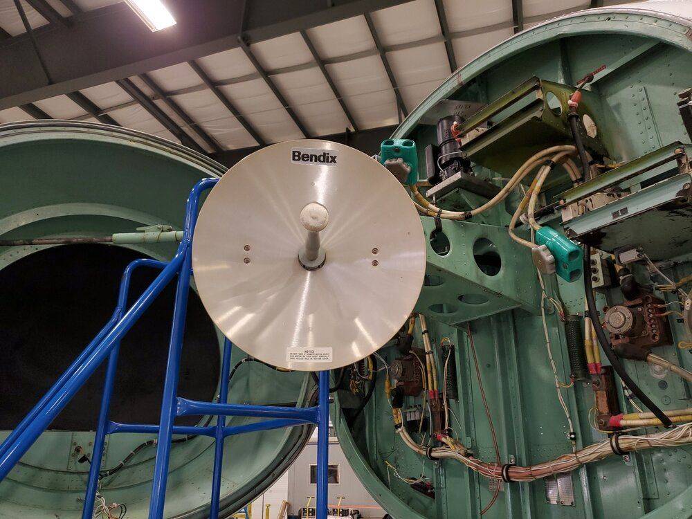

You will find it much easier to use a single reflector dish. If you consider the focus of a parabola, it is in the middle of an image plane. Signals from slightly different directions will map onto that plane. So by placing all your antenna elements near the focus on one dish, you can greatly increase the physical stability of the system. What is the diameter of the dish you will use? Your suggested 20” between centres is about 500 mm, so your array would be about 1 metre across. Let's replace that with a single 1 metre dish = 1000 mm. At 915 MHz the wavelength is 300 / 915 = 328 mm.
With a 1000 mm dish, the beam width between the -3dB points will be 57° * 328 / 1000 = 18.7°.
So the -3dB point (where the offset elements could be placed) will be 9.3° off the prime focus.
Let's assume a 750 mm focal length, we get antenna element separation of 750 * Tan( 9.3° ) = 123 mm. That is about the size of the problem. Adjust what you will to make it fit.
You must also design the elements. Will the signal be linear or circular polarised?
There are mobile phone bands around there so there is a question of interference from other channels or operators. Your RSSI is 400 MHz wide, so is highly likely to be receiving other signals, including from aircraft.

As far as a parabolic dish goes, I do have an old radar dish off one of our old HS748 aircraft. It is 18" diameter with a thru- hole in the center, so easily adaptable for mounting the new elements.
Circular polarization would be my preference as it has better resistance to reflectivity to avoid multipath issues.
The elements would most likely need to be custom fabricated, as I am not likely to find off the shelf solutions.
