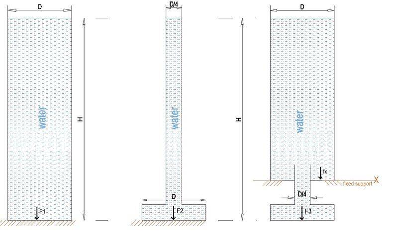

hello all ,
1st and 2 nd water containers sit on ground and 3rd type of water container sit on fixed support along X axis and bottom parts are suspended in air , pls see picture , the drawing is half cross sections of cylinders
All water level heights H and tubes D diameter are same ,
Hydrostatic forces on bottom face of containers , F1 ,F2 ,and F3
by the formula F=pgh x A , F1 and F2 are same , but , i think that F3 is not same , it is much less than F1 and F2 . am i right ? so , how i calculate F3 force ?

What is holding the T piece at the bottom of #3 in place? Or is it in the process of falling?
lets consider 2 cases ,
1. T piece is stationary fixed , welded along x axis
2 . T piece is falling down

I'm not very sure, but I think the platform of the second container is a cube and we should be given the length of its one more dimension (the one going into the page).
drawing is half cross sections of cylinders ,

F1=F2 = pgH x A = 1000 x 9.8 x H x 3.14 x D x D / 4

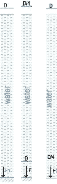

Here's the three central columns:
does this picture ring a bell ?

in my opinion, F3 is not possible to be same equal force to F1,F2 , because there is also hydrostatic fx force on level of X line ,
and i think that if F3 is same with F1 , our energy conservation law saying that it is not possible to be almost doubled hydrostatic force if we consider fx as hydrostatic force

The idea of the picture in #16 was: these columns are exactly identical. Any forces on the sides can only work in a horizontal direction and therefore not exert any contribution in the vertical direction. And for all three we have $$\Delta p = \rho \,g\,\Delta h$$
The composer of the exercise was (is) just trying to confuse you by adding extra stuff on the sides.

Is your thought that the reaction force to fx (i.e., fx upwards on the water) is helping to support the water, so it needs less support at the bottom? If so, you need to consider all the vertical forces on the water. Those include a downward force from the upper face of the horizontal part of the T.
If you were to add variables for all the different heights and cross sections in the diagrams, you would find that for these forces to add up to balance the weights of water then F1=F2=F3. But of course it is much simpler just to apply the pressure law: at depth H the pressure is ##\rho gH#, so if the bases are all the same area then the forces there are all the same.
