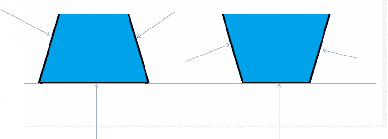

Pressure is equal or force is equal at the bottom?
31 replies · 6K views · last reply
Ravi Singh choudhary
123
Two blue trapezoid containers of equal height side by side on a horizontal line, the left one wider at the bottom and the right one wider at the top.
Problem Statement:
Both containers are just equal in volume and having same height; you can assume one is upside down of another. What is pressure at the bottom of the containers. Let's say left side is container 1 and one on right side is 2.
Relevant equation:
Equation Δp = ρgh, pressure change equals density times gravitational acceleration times depth, written in handwritten-style typeset math.
h is the depth of fluid from the top surface of fluid.
My attempt:
Thought 1
: Pressure will be equal at bottom for both the cases; and force to the bottom we can find with multiplying the respective bottom surface areas.
Thought 2: As volume and density of both the liquid is same; so the mass. When we draw free body diagram of the liquid, it appears the forces will be equal at bottom will be equal not the pressure.
  • Two blue trapezoid containers side by side on a horizontal line: the left one is wider at the bottom than at the top, and the right one is wider at the top than at the bottom.
Paul Colby said:
I like your second thought. What is the total upward force on the bottom in terms of the pressure?
Let's try this; I am connecting piezometer to the both tank near bottom sideways. What will be the level of liquid in the piezometer; it is same or different.
For a fluid at or near equilibrium, pressure in any horizontal plane (actually, a surface of equal g) will be equal. What that will be depends on the weight (force). Consider a nail (spike) and a 20 kg weight. Which would you prefer: 1). The weight on top of the spike on top of your toe OR 2) the spike on top of the weight on top of your toe? Would you argue that it makes no difference to your toe?
Ravi Singh choudhary said:
My attempt:
Thought 1
Yes.
When you draw the free body diagram of the fluid, don't forget the forces on the fluid exerted by the sloping sides.

TSny said:
Yes.
Weight of bodies are equal, so the forces. How pressure can be equal.
Yes, the weight of the fluid is the same in each container. When you speak of force, what particular force are are you referring to?
See post #5.
For the right hand vessel the force acting on the base is NOT just the pressure multiplied by the area of the base. There is also pressure acting vertically on the sloping sides and these also press on the base.

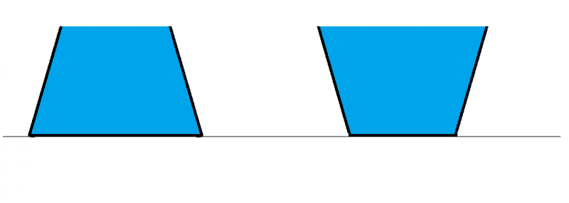

Here is the FBD of fluid only; neglect the black lines resembling the walls
Free-body diagram of two fluid shapes resting on a horizontal line: a trapezoid wider at the bottom, and a trapezoid wider at the top. Arrows point to the sloped sides and the flat bottom of each.
I am very much satisfied with TSny; When I would put weighing machine below the container; I would have same weight for both the container.
My thought is; I would connect a piezometer to the both of the container, it would have same fluid column height that means same pressure; since childhood we are reading pressure is scalar and independent of shape of the container. Horizontal component of forces of due to side walls will be nullified in both the cases.
What is the difference between two condition is the component of force that is only acting to the flat bottom. The net force on bottom is same for both the cases.
Moral of the story: net force to the bottom and pressure at bottom will be equal, the difference is the normal force acting only to the flat bottom.

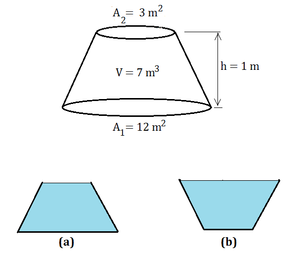

I want to make sure I follow what you are saying. So let's take a numerical example. See diagram attached below, which shows numerical values for the top and bottom areas of the container as well as the height and volume of the container.
Take the density of the fluid to be 1000 kg/m3 and g = 10 m/s2. Atmospheric pressure is just a distraction, so let’s set atmospheric pressure to zero (we can always add that back in later, if we want). Also, neglect the weight of the empty container. Assume the container sits at rest on a table.
For the orientation shown in figure (a), find
(i) fluid pressure at the bottom of the container
(ii) force that the fluid exerts on the flat bottom of the container
(iii) force that the flat bottom of the container exerts on the table.Repeat for the orientation shown in figure (b).

Here are my observations for this setup .
1) The liquid pressure at the bottom of the two containers will be same , but the force exerted by liquid on the flat bottom would be different . Higher in case a) as compared to b) . By Newton's III law the flat bottom would be exerting a higher force in the first case .
2) If the two containers were placed on weighing scales , then the reading would be same .
The interesting part (for me ) is that even though liquid is exerting higher force on the flat bottom in the former case , the table beneath the two containers will be pushing the two containers upwards with the same force . If Fs represents vertical component of force due to side walls on the liquid and Fbot represents force due to flat bottom on the liquid and W represents force due to gravity on the liquid then ,
In the first case Fbot = W + Fs . In second Fbot = W - Fs . Clearly Fbot,1 > Fbot,2 . The table would be exerting upward force equal in magnitude to W on the container in both the cases ( assuming negligible mass of the container ) .
Ans (i) ρ*g*h for both the cases; 1000*10*1=10000 Pa
Ans (ii) Case (a) Pressure*Area = 10000*12=120000 Case(b) 10000*3=30000
Ans (iii) ρ*V*g for both the cases; 1000*7*10=70000
Yes. That's right. Good work.

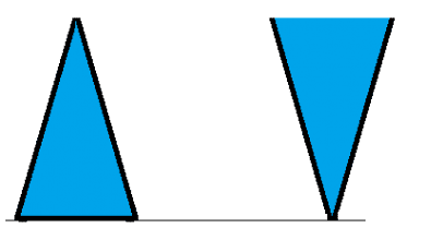

Interesting to consider what happens if you reduce the width of the containers until the one on the right has no base.
Two blue filled containers side by side on a horizontal line: the left is a tall triangle with its wide flat base on the line, the right is an inverted triangle with its flat top open at the top and its point touching the line.
You mean this. What's the difference.
Well now try applying the two "thoughts" you mention on post #1
