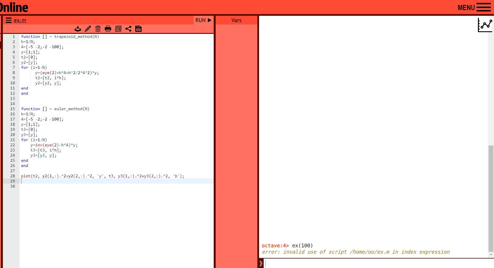

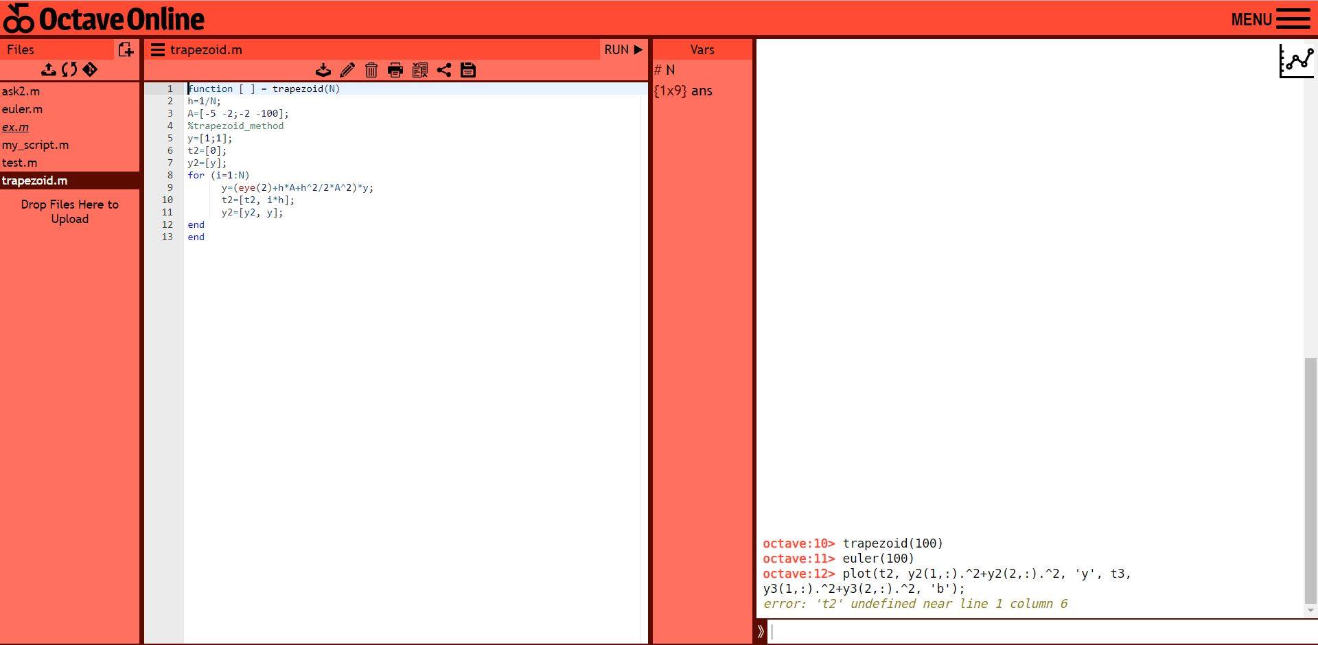

There are two functions that I want to plot. Here you can see the functions I wrote then I press RUN and enter 100 as the value for N and as you can see I get again an error message. What have I done wrong? (Thinking)
If we put a function into a file named [M]ex.m[/M], then that file must contain exactly a function named [M]ex[/M] and no other statements.
Since that is not the case, we get an error that is unfortunately not very descriptive. (Worried)If we copy and paste your code into the regular command prompt of Octave online, we get:
Now we get the error that the variables are not known as I explained. (Nerd)Alternatively, we can create a new file named [M]trapezoid_method.m[/M].
Put the code of the function in there, and only that function.
Click the save button.
Type [M]trapezoid_method(10)[/M] on the command prompt.
Now it will execute the function as desired. (Happy)

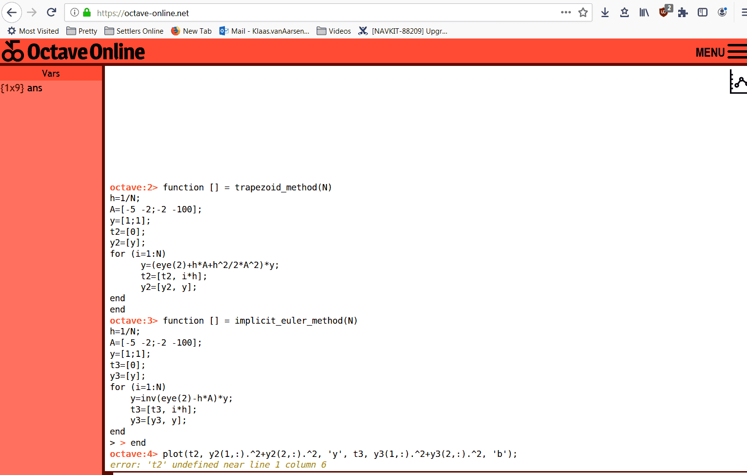

Then in the command line I wrote the following commands:
octave:1> trapezoid(100)
octave:2> euler(100)
octave:3> plot(t2, y2(1,: ).^2+y2(2,: ).^2, 'y', t3, y3(1,: ).^2+y3(2,: ).^2, 'b');
but I get again "error: 't2' undefined near line 1 column 6". What am I doing wrong? (Thinking)

evinda said:
And what if we write these two function into one?
I mean like that:
So that the variables are known, does the function have to return these? Or how can we fix the error that we get, that the variable are not known?
That should work yes.
Does it? (Thinking)
evinda said:
I splitted the two functions into two files, the following:
Here's how it looks like at me:

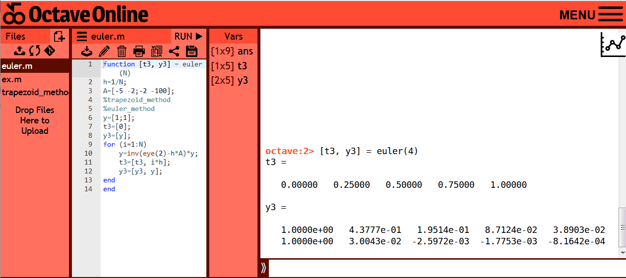

Now we do not get the error that there is something wrong with the script any more. Good! (Happy)
The variables still need to be returned though.
We can do that with:
[M] function [t3, y3] = euler(N)
...[/M]
and:
[M]function [t2, y2] = trapezoid(N)
...[/M]
and:
[M]octave:1> [t2, y2] = trapezoid(100)
octave:2> [t3, y3] = euler(100)
octave:3> plot(t2, y2(1,: ).^2+y2(2,: ).^2, 'y', t3, y3(1,: ).^2+y3(2,: ).^2, 'b'); [/M]

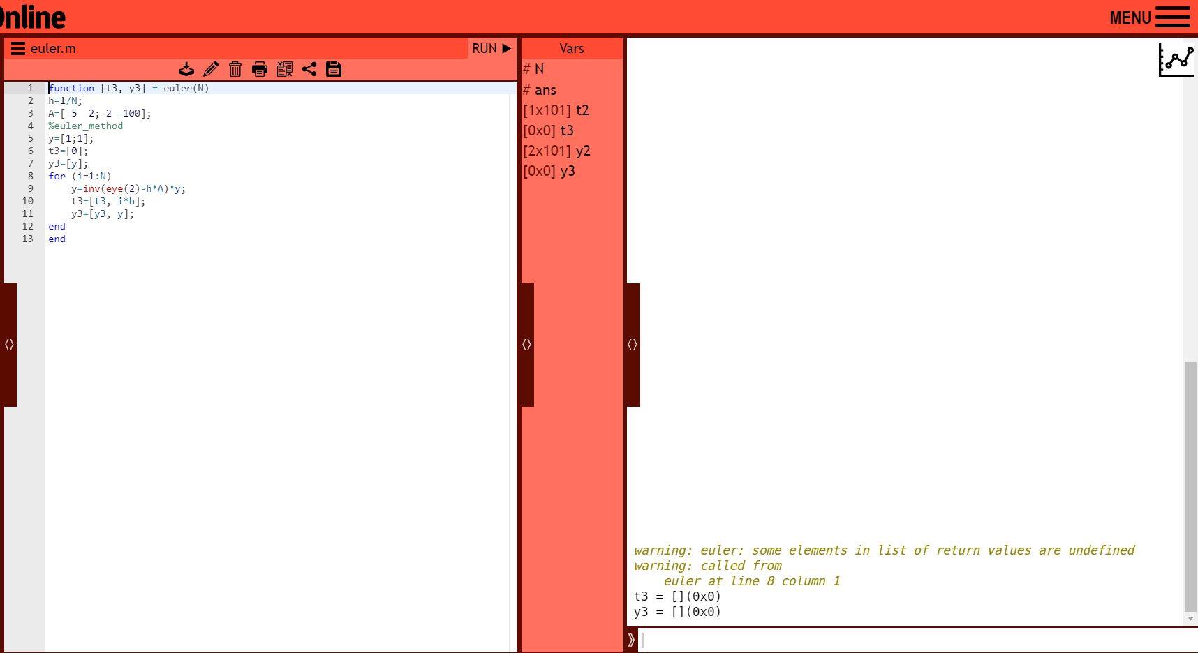

I tried it like that. The command "[t2, y2] = trapezoid(100)" works. But the command "[t3, y3] = euler(100)" seems not to work, I get the following:View attachment 9070(Thinking)
