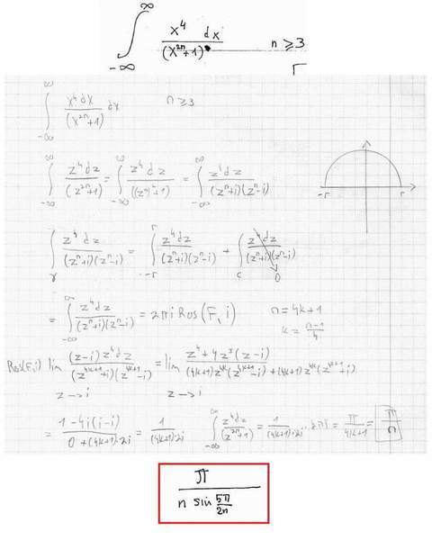

Hey guys.
So, I need to calculate this integral, I uploaded what I tried to do in the pic.
But according to them, this is not the right answer, according to them, the right answer is the one I marked in red at the bottom.
Any idea where this Sin came from?
Thanks.

One way sin may appear is from combining exponetials
sin(z)=[exp(iz)-exp(-iz)]/(2i)
Try this
integrate around a pie slice
one edge
z=t t in (0,R)
one edge
z=t*exp(pi*i/n) t in (0,R)
the rounded edge
z=R*exp(pi*i*t/n) t in (0,1)
let R become large
express the integral of the pie slice in terms of I then as 2pi*i*Res(f,exp(pi*i/(2n))
can you explain to me how you got that term to drop out to 0, when you integrated round the contour from R to -R? did you find a bound for the integrand?
When R goes to infinity, the integral of the semi circle goes to zero.
yes. but don't you need to find a bound, say M, such that the integrand is less than or equal to M at all points on the semi circle and then say as R goes to infinity the bound goes to 0.
my question was, what did you use to bound the intergal?
Oh, I thought it's right for any semi circle integral so I didn't try to prove it.
Now I'm not sure.
So for the curved edge
recall n>=3
|integral(curved edge)|<|R^4/(R^(2n)+1)|(2pi/n)*R<|R^5/R^(2n)|C<=C/R->0
The same bound holds for a semicircle (times n)
***It is easier to do a wedge than a semi circle as one avoids the sum of n residues only one appears.***
ok. how can you assume [itex]n \geq 3[/itex]
It is given in the problem statement.
