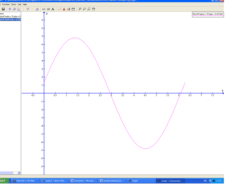

Two alternating currents are applied out of phase with each other. One is 4 volts and the other is 3 volts 27° out of phase.
These can be written as (4, 0°) and (3, 27°)
a)draw both phasors
b)draw the combined phasor between (0 degree and 360 degree)
c)label peak voltage and state its value
a)A rough drawing on paint http://imageshack.us/photo/my-images/3/plotb.jpg/
b) I know A= 6.8106 volts by using this formula
r=√a2+b2
r=3cos27 + 4i + i(3sin 27)
r=√(3cos27 + 9)2 + (3sin27)2
=6.81v
angle=0.2014
Image 2 attached.
Please look at both images, which are correct

Your work looks OK, but I think your answer to (b) should be a picture of a phasor (which I don't see anywhere) and your answer to (c) should just be a number.

Part (a) Said draw both phasors. That's apparently what you did in image 1, although I would put a little arrowhead on the tips of both.
and for c the number (=6.81v ).
And last but not least should I label (6.81v) on graph B.
Thanks again
Part (b) asks for the "combined phasor". That is another phasor like in part (a). It is just the result of adding the two given phasors and would be easy to include in your image 1. But when it asks for the combined phasor "between 0 and 360" maybe it means the corresponding sine wave like in your other image. Either way the 6.81 is the amplitude of the sine wave you have drawn and is also the length of the combined phasor, which you have not drawn yet.

You calculated its length and angle (in radians) in your first post. Just draw it like you did the others. Or you could geometrically use the parallelogram rule for adding the two vectors (phasors) in your first picture. Or if it's the sine wave they want, you have already drawn it.
