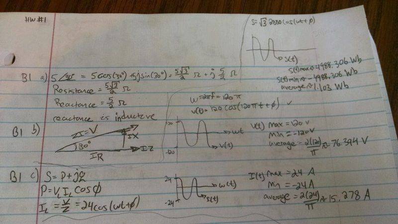

Alright so I believe I solved part a correctly. It was very easy.
(A) 5 * phasor of 30 degrees
However it's been a while since I took circuits 1, so I'm struggling a bit with part (b). You can see my work in image 3 attached. For the phasor diagram for the voltage I drew IR as the reference along the positive x axis, IX point upwards, and the hypotenuse as ZI=V at an angle of 30 degrees from the reference. I believe this is correct?
I'm not exactly sure how to solve for the current here. I know ohms law V = IR, and I know that generally speaking we can write alternating current in terms of trigonometric functions, so the voltage as a function of time is something along the lines of
V(t) = A*sin(w*t + phase)
The problem specifies that it's at 60 Hz and I know that
w = 2*pi*f = 120*pi
So I know that the voltage is of the form
V(t) = 120*sin(120*pi*t + phase) volts
So
I = V/Z, but I can't seem to remember how to get the voltage into phasor form when I don't know the phase angle, hence I'm not sure how to draw the single phase diagram, or how to get the phasor current in this case. I guess I have a hard time putting the English into mathematical equation.
(C) I'm not exactly sure how to draw these graphs
For the voltage I drew the max as 120 volts, the min as -120 and I found the average as (2*max)/pi. I found this formula online, I believe it's correct?
I guessed that the current was in the form of 120/5 or 24 times some phasor
I(t) = 24 * phasor so I drew the max as 24 the min as -24 and used the formula for average above
For the power S I believe it's of the form sqrt(3)2880*some phasor
I don't see how to draw these graphs without given the initial phase angle of the voltage. Any help in solving either of these parts would be greatly appreciated. Thanks guys!

Handwritten homework notes on lined paper titled HW #1 covering AC circuit phasors: part a) 5∠30° = 5cos(30°) + j5sin(30°) = (5√3)/2 Ω + j(5/2) Ω, a phasor diagram for part b) with IR, IX, IZ and V at 30°, and sine-wave sketches with peak and average values for parts b) and c).
are you sure about that formula? think about what a sign wave is. sin(x) what is the average. Think about what a sign wave does.
V=I/Z
ohms law should help you find the current.
if no phase is given, typically you can assume zero.
power=voltage*current
ok so
V = 120 phase angle
Z = 5 phase angle 30 degrees
V = IZ
so
I = V/Z = 24 phase angle -30 degrees
S = IV = (24 phase angle -30 degrees)(120) = 2880 phase angle -30
IR drop is 24 phase angle -30 degrees ( (5*sqrt(3))/2) ~ 103.923 phase angle -30 degrees
IX drop is 24 phase angle -30 degrees (5/2) ~ 60 phase angle -30 degrees
So I seem to get that with your post, but how exactly do I draw the phase diagram of these things?
I know that I can draw Z = (5*sqrt(3))/2 + j (5/2) with a phasor with the (5*sqrt(3))/2 along the positive x axis, 5/2 along the positive y axis, and the other side of the triangle as Z = (5*sqrt(3))/2 + j (5/2) with a angle of 30 degrees
I can assume that the voltage has a phase angle of 0 degrees? In that case the phase diagram is just 120 along the positive x axis?
For the power phasor diagram, I can express S = 2880 cos(-30 degrees) + j 2880 sin(-30 degrees)
S = 1440 - j 1140*sqrt(3)
so the phasor diagram would just be 1440 in the positive x direction, 1140*sqrt(3) in the negative y direction, the other side of the triangle would be S = 1440 - j 1140*sqrt(3), and the angle would be -30 degrees
But how do I draw a phasor diagram for IR and IX drop is this talking about the real part of the current times the real part of impedance along with the imaginary part of the current times the imaginary part of the impedance? Isn't this just the phasor diagram mentioned earlier of the voltage? Kind of confused about this one.
Thanks for your help!
