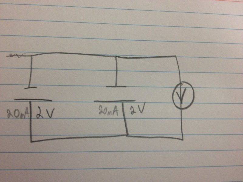

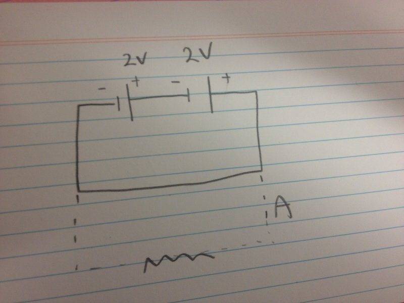

i) A particular source of potential difference is capable of providing a maximum potential difference of 2 Volts. Sketch how you would connect two such sources to provide a potential difference of 4 Volts.
ii) If each source can provide a current of 20 mA before its potential drops to 1.5 Volts, sketch how you would connect them to provide a current of 40 mA at 1.5 Volts.

i)
As voltages sum in series circuits I assume this drawing is correct? Any part of the circuit not between the two 2 volt cells will measure 4 volts?.

As amperage sums across a parallel circuits and voltages do not I assume that my drawing is correct? I'm going off of the assumption that both cells are now producing 1.5volts due to the electricity having to pass through 2 cells now each lap of the circuit. Would the voltmeter give a reading of 1.5volts (and 40mA even though it shouldn't be able to measure amperage)?

i)View attachment 74563
Yes, connecting the batteries in series is the right idea, but you've drawn a short circuit across the result. Besides draining the batteries very quickly, anything connected in parallel with the short will see no potential difference.
Instead of a short circuit, why don't you sketch in a resistor as a load?
ii)View attachment 74565
The parallel connection idea is right, but your reasoning for the drop in potential is not. Real batteries (as opposed to ideal ones) are not perfect. They have internal resistance that drops the potential seen across the battery terminals as the current drawn increases. "Laps of the circuit" are irrelevant. What matters is the amount of current drawn by the load.
Your diagram shows two cells and a current source in parallel. Was that intentional? As it stands the current source will be driving current into the + terminals of the batteries, thus charging the cells rather than the cells discharging into a load. Note that the longer line segment of the cell symbol represents the + end of the cell.
If you want to demonstrate the parallel connected cells delivering 40 mA at 1.5 V, why not draw in a resistor load and use Ohms law to give it an appropriate value? Then indicate on your circuit the current and voltage.

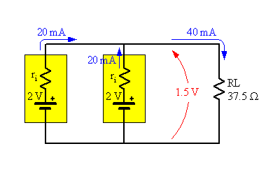

For ii) http://imgur.com/Fa8jyqR
I just replaced the V with a resistor with 37.5 ohm that I worked out using ohms law, I know this would work if I had just one 40mA cell but I'm not sure on how to account for the different currents in each branch. Would the circuit directly after the resistor be providing a 40mA current (at least before it reaches the first battery?). Sorry for all of the questions, I'm just finding this really hard to wrap my head around.
Each cell will provide 20 mA for a total of 40 mA that passes through your load resistor. So something like this:
The yellow boxes represent the non-ideal cells with their internal resistances that cause the voltage drop down from the ideal 2V when current is drawn. You could work out a value for them, if you're keen :smile:
