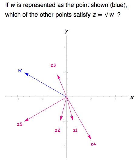

If W is represented as the point shown in blue which of the other points satisfy z=Sqrt[w]?
(The answer is Z2)[/B]
I'm trying to study for a test and this is a practice problem and the book doesn't go into great detail about this sort of problem graphically but I think I have it figured out, just maybe not the best way of going about it.
Because the power is 1/2 I imagine that means there are 2 Square roots of the complex number. Each varying by 2*pi
I'm assuming W looks like its at 5pi/6 = 150 degrees just for reference.
150/2=75 degrees
(150+360)/2=255 degrees
I move 75 degrees from the x-axis and there is no line there so I go to my next option.
Then I move 255 degrees off the x-axis and think maybe I hit where Z2 is located. Is my logic correct?
Is there a more proper way of going about this? Or faster?

I think you are doing the right thing there, and the proper answer is "none of the other points"!
z2 satisfies ##z^2 = w## but not ## z=\sqrt w##.

Your reasoning is largely correct.
The statement Which I placed an asterisk next might better read something like:
Because the power is 1/2, that means there are 2 Square roots of the complex number. The square of each differing by 2π.​
Sometimes it's easier to see graphically if you consider that the given vector (or point or complex number) is at some negative angle. In this case that's -210° (i.e. 30° more negative than -180°). Half of that is -105° (15° more negative than -90°)
Generally, check the magnitude of the vector / complex number..

I learned that the range of ##\sqrt z## is the right half of the complex plane only. Math dislikes multiple-valued functions.
The correct answer in this problem happens to be in the left half of the complex plane.

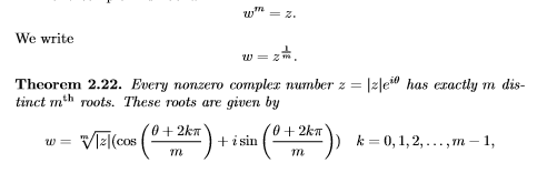

I would say, there are two roots differing by pi. (Not by 2*pi. )
In general for nth roots they differ by 2π/n and one root is at θ/n

Yes, but only one of them is √w. The other is -√w. The z2 shown could be -√w.

Let's see now. What was the initial question?
If we take the strict interpretation that the problem asks us to use a strict interpretation of ##\ \sqrt{w}\ ## as the principle square root, that is the square root in the right half-plane or on the positive imaginary axis, then none of the vectors is correct.
If we take the problem to mean, "Find ##z##, such that ##\ z^2=w\ ##," then ##\ z_2 \ ## is the solution as OP found.
