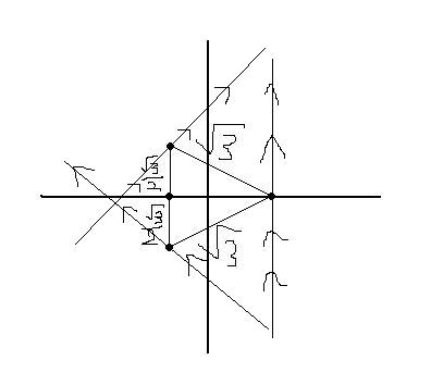

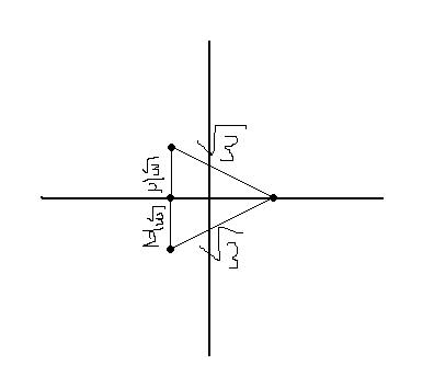

Here's my basic proof of the equilateral triangle:
Coordinate axes with three points forming a triangle: one vertex on the positive x-axis, two vertices left of it symmetric above and below the x-axis, joined by segments; labels show sqrt(3) on the two slanted sides and |a| sqrt(3) on the vertical side.
With z = 1 etc. for the vertices.
But how to show the rotation?
Thanks.

For the triangle question, I find it strange that the sources can rotate, but this question can still be solved if we assume that the vortices move with the velocity flow.
I believe that after working it out, the velocity flow at each vortex is in a tangential direction, and [tex]Period = 2 \pi / |v|[/tex].
To find the fourth vortex, we know that the flow at each vortex is tangential, so we introduce a fourth vortex that eliminates this tangential component.
