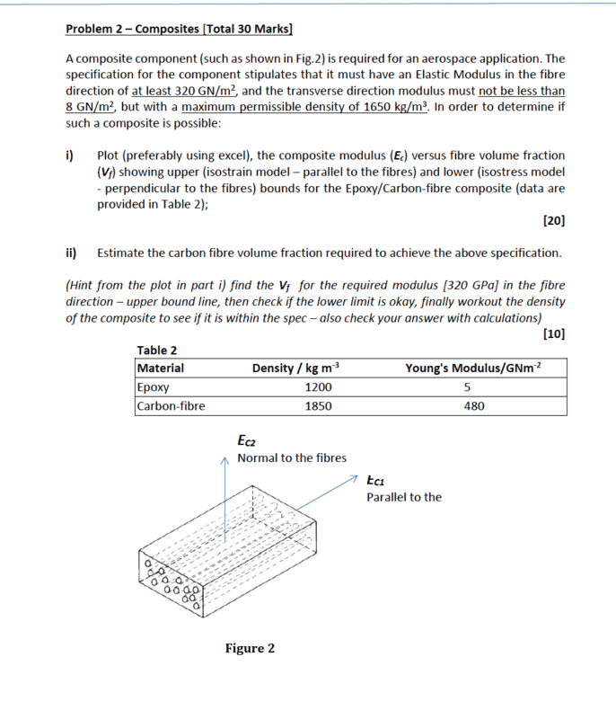

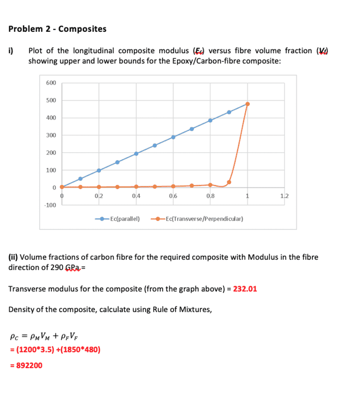

Hello. My question is related to Materials & Manufacturing. I have attached the question plus my solution. Pls guide me if its okay

Questions and solutions cannot be in images. You need to post them directly using the PF LaTeX feature. A link to the LaTeX guide is at the bottom left of the post window.
If you're going to post screenshots, it's more convenient for the reader if you put the image link between [img] [\img][/size] tags (or use another method, e.g. you could edit your post and click the 'full image' button on the image list below the text box) to post the full image rather than only a thumbnail. Here are your 2 images, reposted for other readers.
Your solution looks ok to me, but this is not familiar territory to me, so I think that you should please wait for another member to confirm.

Thanks a lot, I made the images big. Can you please tag someone who will be able to help me confirm

Yes, all of this is correct (with the proviso that an Excel chart can be used to help support an answer, but should not be the entire attempted solution by itself). But as much as possible should still be posted directly, so that replies can quote just the particular things they are replying to. There is plenty in this question that can be posted directly.
