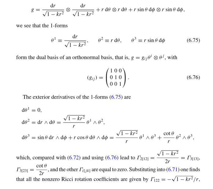

I'm reading "Differentiable manifolds: A Theoretical Physics Approach" by Castillo and on page 170 of the book a calculation of the Ricci tensor coefficients for a metric is illustrated. In the book the starting point for this method is the equation given by:
$$d\theta^i = \Gamma^i_{[jk]} \theta^j \wedge \theta^k$$
where ##\theta^i## are 1-forms.
Then the book proceeds to calculate the coefficients for the following metric:
What I don't quite understand is why is the coefficient for ##\Gamma_{2[12]}## is given by ##\frac{\sqrt{1-kr^2}}{2r}##. From the second equation I would have guessed the coefficient is actually ##\frac{\sqrt{1-kr^2}}{r}##, so why do we need to divide by 2? From the second equation I would read $$d\theta^2 = \Gamma_{[12]}^2 \theta^1 \wedge \theta^2$$.
Also I'm not sure how the book actually computed the term for ##\Gamma^3_{[13]}##.

There is summation in the formula
##d\theta^2 = \Gamma^2_{[jk]} \theta^j \wedge \theta^k=\cdots+\Gamma^2_{[12]} \theta^1 \wedge \theta^2+\Gamma^2_{[21]} \theta^2 \wedge \theta^1+\cdots=\cdots+2\Gamma^2_{[12]} \theta^1 \wedge \theta^2+\cdots##

Ok I see, so for the term ##\Gamma^3_{[13]}##, we used the last equation. My point of confusion is why we don't care about the factor involving ##\theta^2 \wedge \theta^3##
I'm going to be explicit!
$$d\theta^i = \Gamma^i_{jk} \theta^j \wedge \theta^K$$
$$d\theta^3 = \Gamma^3_{11} \theta^1 \wedge \theta^1 + \Gamma^3_{12} \theta^1 \wedge \theta^2 + \Gamma^3_{13} \theta^1 \wedge \theta^3$$ $$+ \Gamma^3_{21} \theta^2 \wedge \theta^1 + \Gamma^3_{22} \theta^2 \wedge \theta^2 + \Gamma^3_{23} \theta^2 \wedge \theta^3$$ $$ + \Gamma^3_{31} \theta^3 \wedge \theta^1 + \Gamma^3_{32} \theta^3 \wedge \theta^2 + \Gamma^3_{33} \theta^3 \wedge \theta^3$$
Reducing this down (which property of exterior derivatives did i use to reduce to this point?), we get:
$$d\theta^3 =\Gamma^3_{12} \theta^1 \wedge \theta^2 + \Gamma^3_{13} \theta^1 \wedge \theta^3$$ $$+ \Gamma^3_{21} \theta^2 \wedge \theta^1+ \Gamma^3_{23} \theta^2 \wedge \theta^3$$ $$ + \Gamma^3_{31} \theta^3 \wedge \theta^1 + \Gamma^3_{32} \theta^3 \wedge \theta^2$$
Now, we know that ##d\theta^3 = \frac{\sqrt{1-kr^2}}{r} \theta^1 \wedge \theta^3 + \frac{\cot \theta}{r} \theta^2 \wedge \theta^3##
Match the same with the same. Which terms involve ##\theta^1 \wedge \theta^3##? You're not ignoring the ##\theta^2 \wedge \theta^3## terms, it's just that ##\Gamma^3_{13}## doesn't have any ##\theta^2 \wedge \theta^3## terms!
Also, some food for thought, what can you conclude about ##\Gamma^3_{12}, \Gamma^3_{21}## from this equation?

In holonomic bases ("coordinate bases") in a space without torsion (as in standard GR) the connection coefficients are the Christoffel symbols, which are symmetric in the lower components.
That's different for (pseudo)-orthonormal bases of course.
