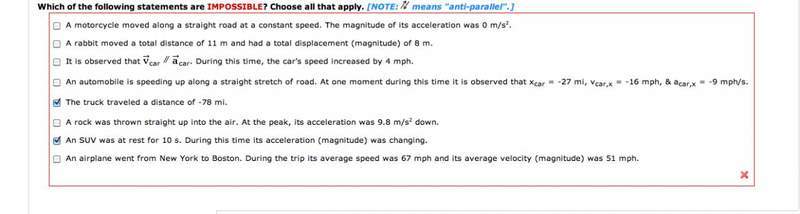

I have some concept problems that I cannot seem to master. I have them narrowed down to what I think the answers are but I keep getting them wrong.
I'm supposed to choose all the statements that are false.
A motorcycle moved along a straight road at a constant speed. The magnitude of its acceleration was 0 m/s2. - false...how can it be moving if it isn't accelerating.
A rabbit moved a total distance of 11 m and had a total displacement (magnitude) of 8 m. -true, the rabbit moved from point a to point b and it took 11 m, but point a is 8 m from point b.
It is observed that car's velocity and acceleration magnitudes are parallel. During this time, the car's speed increased by 4 mph. - true, the car's speed increased so the velocity increased because velocity is delta-displacement over time, and acceleration is velocity over time.
An automobile is speeding up along a straight stretch of road. At one moment during this time it is observed that xcar = -27 mi, vcar,x = -16 mph, & acar,x = -9 mph/s. - have no clue...i know that vcar is velocity, and acar is acceleration.
The truck traveled a distance of -78 mi. - false, it seems stupid to say a truck traveled a negative amount, but at the same time i just did a problem where distance was negative but that's because I was measuring a rock that was thrown in the air and then went below the initial point that it was thrown from.
A rock was thrown straight up into the air. At the peak, its acceleration was 9.8 m/s2 down.- false, at the peak it's acceleration would be 0, then as it fell its acceleration would be 9.8 m/s2.
An SUV was at rest for 10 s. During this time its acceleration (magnitude) was changing. - false, how could it be accelerating if it's at rest?
An airplane went from New York to Boston. During the trip its average speed was 67 mph and its average velocity (magnitude) was 51 mph. - false, speed is a scalar of velocity ( a vector), and a scalar cannot be greater than its vector, correct?
This is an online question (must choose all that are false to get it right), and this is what I think but it keeps saying I'm wrong.

you know what. I just came up with some different answers and explanations. I uploaded the questions this time.
Now I see why some of the questions seemed strangely worded--they are possible/impossible questions--not "true/false". Thanks for clearing that up.

Here is my final thoughts.
-if the motorcycle is moving at a constant speed and changing position at a constant (linear) fashion, the it is not accelerating. So this is possible.
-This is possible, the distance traveled can always be greater than the displacement.
-This is possible, because velocity is displacement over time, and acceleration is change in velocity over time, and if the displacement changes by 4 mph, then the acceleration will change slightly as well, and the lines will stay parallel.
-this is possible, the automobile went past its point of origin and started moving in the negative direction, and if the position is negative then the velocity and acceleration will be negative.
-this is impossible, we don't just say something traveled a negative distance, now if a point of origin were included then this would be possible.
-the up direction is chosen as positive, so the rock reaches +9.8 m/s2 then reaches 0, then goes to -9.8 m/s2. This is possible.
-impossible, if the truck is resting then logically it is not accelerating.
- average speed is total distance traveled over time elapsed, and velocity is the speed of something in a given direction over time. So this is possible, the total distance traveled can be greater than the speed the object is moving in over time.
