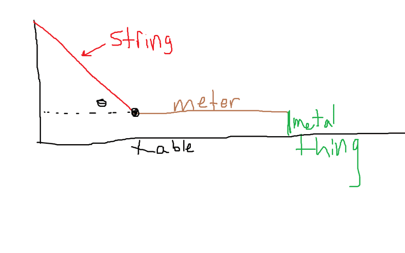

Hello! Suppose there is a meter stick suspended from and parallel to a table. On one end, the meter stick is held up by a piece of string at an angle. On the other end, the meter stick is held up by a metal thing about 10cm tall, simply allowing the stick to rest upon it. Remember, the meter stick is parallel to the ground... How would one find the normal force exerted by the metal thing that the meter stick is resting upon? Thank you very much

There must be friction (or some other horizontal force) at the metal support, otherwise the string would draw the stick to the left until the string were vertical.
Taking moments about a point will help to find the components of the reactions.
