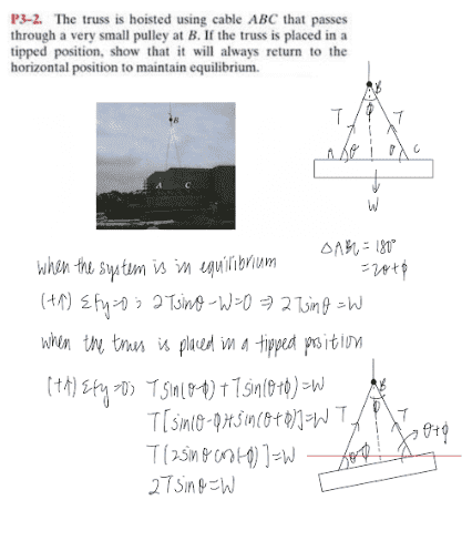

The truss is hoisted using cable ABC that passes through a very small pulley at B. If the truss is placed in a tipped position, show that it will always return to the horizontal position to maintain equilibrium.
ΣFy=0
I am not sure whether I can prove like this, I am trying to explain it with the angle .
It seems to me that something is off here.
Perhaps I am wrong, but I believe the pulley, if of little friction, will prevent the truss from naturally returning to a horizontal position.
If the center of mass of the truss can relocate itself to a lower position, it will.

but the question needs us to prove that it will return to equilibrium
Exactly the problem.
Let's wait for some input from mentors of this forum; they will help you for sure.

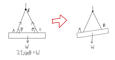

It is unclear what your tipped diagram represents. There are two degrees of freedom: the arrangement (including the cable above the pulley) may swing to one side as a unit, with no cable moving through the pulley; and the cable can move through the (stationary) pulley with the bar's mass centre remaining below it. In general, any combination of the two.
Your diagram as drawn seems to represent both aspects, but your equations are only correct for the case of swinging as a unit. E.g. consider the case where so much cable has moved through the pulley that the bar hangs vertically. What do your equations give for that?
Now, I am not entirely certain what the question intends. The careful statement that there is a pulley implies you are to consider cable moving through it. Whether you are also supposed to consider swinging is less clear.
I would argue that the two aspects are largely independent, and the tendency of the swing to keep returning to the centre is obvious and well known, so here we are only concerned with movement of the cable through a stationary pulley.
Hint: think about potential energy.
Trouble is, if I am right about all that, what you are asked to prove is false!

Then draw your diagram with the beam tilted but its centre directly below the pulley.
centre directly below the pulley?
Yes, the centre of the beam vertically below the pulley, but with the beam tilted. What is the problem?

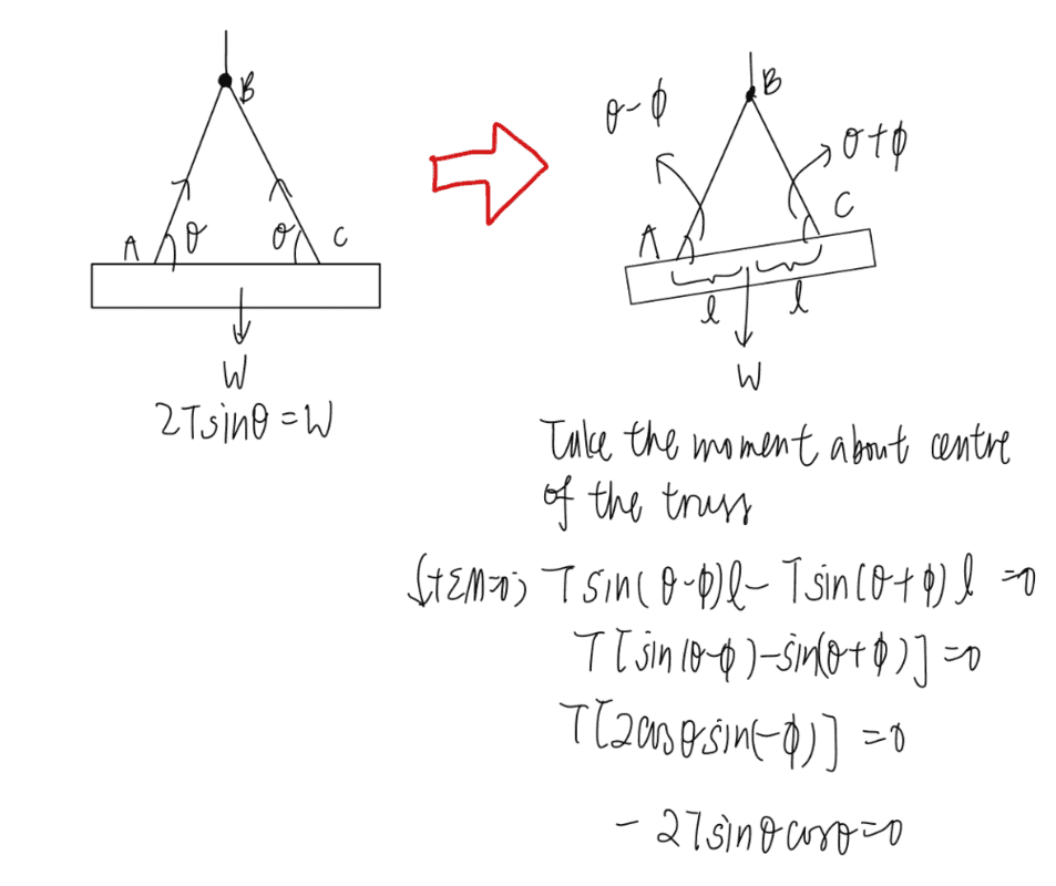

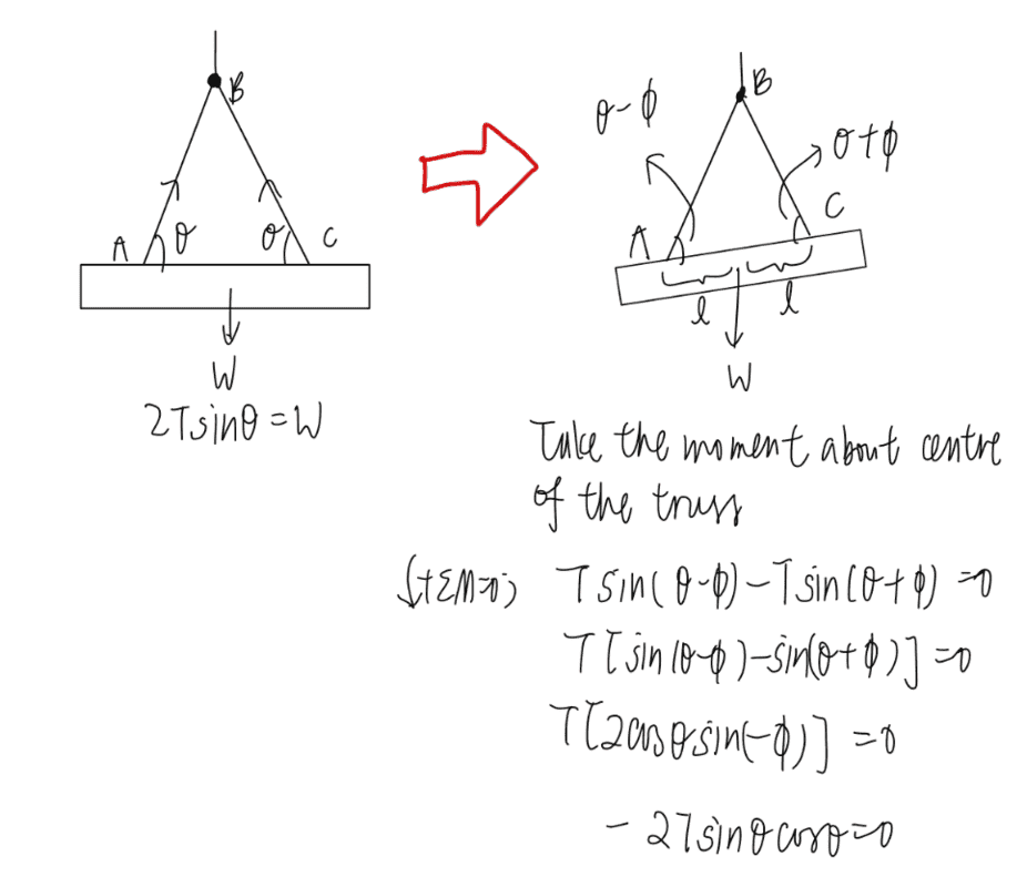

Write in θ and φ for the two angles, as you did originally, and write expressions for the two torques about the centre of the beam.
Is this what you mean?
No. The angle formed by the two sections of cable has changed, so the angles they make to the beam will not have the same total as before.
If you want to keep theta for the horizontal arrangement, call the tilted angles φ and ψ.
