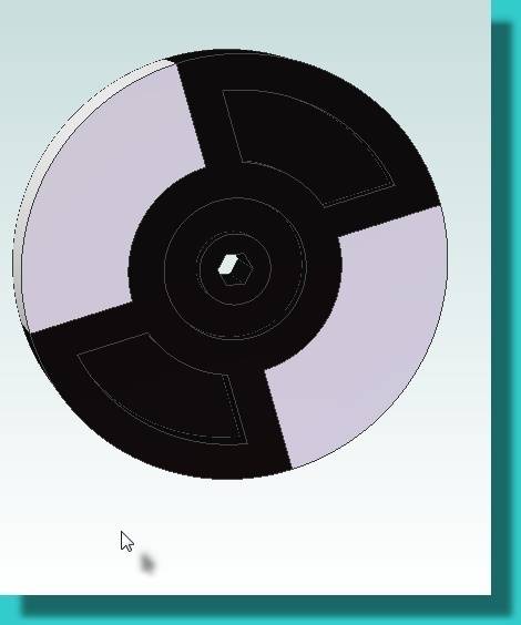

I am working on a project and the image you see is a 12 inch diameter flywheel that weighs 27.006 pounds. The RPM's will be 3600. My questions will be about the very large values I get for the acceleration and force. Since I am most familiar with ft/sec and pounds, those are the units I will use.
Time period for 1 revolution = .01666
V=2∏r/T= 2x3.14159x.5(ft)/.01666(sec)= 188.570ft/sec
A=V2/r=188.572/.5= 71118.0347ft/sec2
centripetal force=mr(4∏2/t2)=27.006x.5x4x3.141592/.016662=1,920,613.646(lbf)
I have checked the math and that force value seems to be very high.
What I would like to know is how much force it takes to spin the flywheel at 3600RPM's. Any help would be greatly appreciated.
Thanks
as I kept working on this I divided 1,920,613.646 by 3600=533.5037. Is that the amount of force per revolution?

0. Assuming no drag. If there is drag then the force is equal to the drag.
Are you looking to find the stress in the disk? Or are you perhaps looking to find the external force that must be supplied to accelerate it?
I'm looking for the external force necessary to spin the flywheel at 3600RPM's.
That is 0. Assuming no drag.

What do you mean by force per revolution? If the wheel is rotating constantly at that rpm, then that is the centripetal force on the rim which acts all the time, not only per one revolution.

The answer has been given twice over. No force at all is required to maintain the rotation.
Any arbitrarily small force is adequate to create the rotation, provided it is applied for a long enouh time.

Here is the equation: [itex]f=0[/itex]
It doesn't take any force to have something spin at a constant speed if there is no drag.
You forgot to divide by g to convert that into pounds force, so the correct value is about 60,000 lbf or 26.7 tons force.
That is the total radial force acting on the flywheel shaft (and the big number is why you don't want to be standing near this machine if something breaks) but it has nothing to do with the force needed to spin the flywheel.

This statement. Any arbitrarily small force is adequate to create the rotation, provided it is applied for a long enouh time. You got to keep putting gas in the tank to keep all the moving parts moving. You have to apply a force to the piston and I believe all of you know the rest of that. That is the force I want to know. Yes there is drag and whatever else. You need a force to overcome those resistances. I have the moment of inertia and can figure the angular momentum, can I find the value I'm looking for with them. Also should I be thinking in terms of torgue instead of force. I hope that you all will help me understand more than I do now. Any help would be greatly appreciated.
Thanks.
Perhaps you should be thinking in terms of energy rather than force. The wheel needs a certain amount of energy to spin. This energy is supplied by a force, but any small or large force will do. As was mentioned, the smaller the force the longer it will take to spin up to speed. But any arbitrarily small force will do. This is where the idea of power, energy per time, comes into play.
Make sure you are clear on the very important differences between the words: force, energy and power. Only when you can clearly distinguish between those words can you start to formulate your question and thoughts about the spinning disc.
The force required is equal to the resistance force. Unfortunately, that is all about the bearings and the environment, and has very little to do with any of the characteristics of the flywheel (except maybe aerodynamics).
Yes, you want to look for the "frictional torque" of your bearing. That should be information that the manufacturer can tell you. Note that frictional torque is a function of speed and sometimes load, so you would need to tell the manufacturer the speed and maybe the load.
