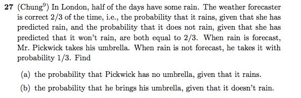

Text problem 27 (Chung) on conditional probability: forecast accuracy 2/3, rain on half of days, Pickwick's umbrella rule; asks (a) P(no umbrella | rains) and (b) P(brings umbrella | no rain).
a) P(Pickwick has no umbrella | it rains) = [itex]\frac{\frac{1}{3}\frac{1}{3}}{\frac{1}{2}} = \frac{2}{9}[/itex], which is the answer according to my answer key.
b) For part b we have:
There is a rain forecast which means he will bring the umbrella. The probability that it won't rain is 1/3.
There is a non-rain forecast which means he brings the umbrella with a probability of 1/3 and it will not rain with a prob of 2/3.
P(Pickwick has umbrella | no rain) = [itex]\frac{1}{3} + \frac{1}{3}\frac{2}{3} = \frac{5}{9}[/itex]. But the answer is apparently 5/12. What have I done incorrectly here?

Printed problem 27 (Chung) about rain forecasts: P(rain | forecast rain) = 2/3, P(no rain | forecast no rain) = 2/3, with parts (a) and (b) asking for umbrella conditional probabilities.

I think you are correct. Let's do it in a simple way, just by counting. Imagine 9,000 days. In 4,500 of those, it rains and in 4,500 it does not. Let's use the notation R = rain, Rc = no rain, F = Forecast rain, Fc = Forecast no rain, U = umbrella, Uc =no umbrella
Lay out the data in a table:
[tex]\begin{array}{lccc}<br /> & R & Rc & \text{tot}\\<br /> F & N1 & N2 & (N1+N2)\\<br /> Fc & M1 & M2 & (M1+M2) \\<br /> \text{tot} & 4500 & 4500 & 9000<br /> \end{array}[/tex]
We are given N1/(N1+N2) = 2/3 and M1/(M1+M2) = 1/3, as well as N1+M1 = 4500 and N2+M2 = 4500. Solving these equations we get N1 = 3000, N2 = 1500, M1 = 1500, M2 = 3000. So, the table is:
[tex]\begin{array}{lccc}<br /> & R & Rc & \text{tot}\\<br /> F & 3000 & 1500 & 4500 \\<br /> Fc & 1500 & 3000 & 4500 \\<br /> \text{tot} & 4500 & 4500 & 9000<br /> \end{array}[/tex]
From this it follows that P(F) = 4500/9000 = 1/2 and P(Fc) = 1/2.
In (b), in the 4500 Rc-days, U occurs in 1500 (F-days) + (3000/3) (Fc-days), for a total of 2500 days. Thus, P(U|Rc) = 2500/4500 = 5/9.
