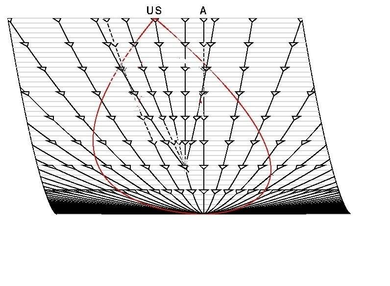

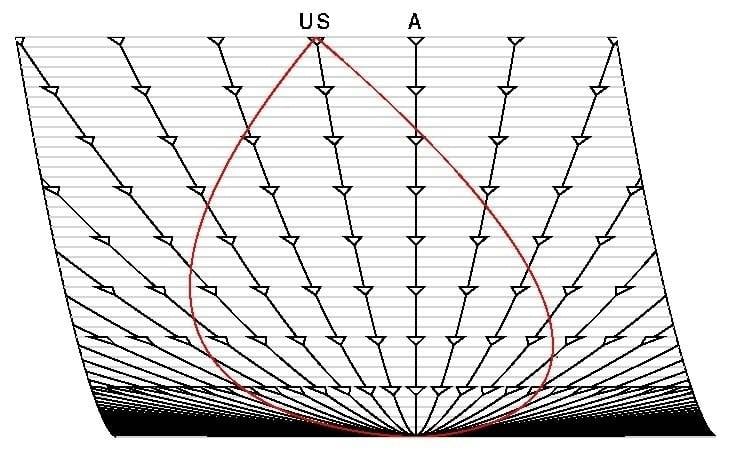

The attached diagrams came from the referenced article. They both are graphs of space vs. time. The Robertson Walker diagram has elements that go to infinite speed. The "conformal" version has all elements stationary. Are these two diagrams supposed to be different diagrams of the same thing, or are they different geometries in the same coordinates?
Is the time parameter in the Robertson Walker diagram supposed to be proper time of particles, or does it represent coordinate time for a hypothetical observer?
  • Spacetime diagram of vertical worldlines with arrowed tick marks, a brown light-cone-like path from the bottom corners meeting at a peak, and a horizontal blue line near the bottom, with yellow triangular markers at the two bottom corners.
  • Diagram of a light-cone-like region in a space-time plot, with a red curved boundary enclosing a teardrop shape; black lines with triangular arrow markers fan out from a point at the bottom, pointing upward and outward, all converging at the bottom edge.
Same geometry, different coords.
Those diagrams illustrate the horizon that exists in an expanding FRW universe. The first diagram uses scaled coordinates, so everything starts in the same place and remains the same distance apart. The straight red lines represent horizons. As time progresses, each worldline loses touch with the others as they move outside its future light cones.
In the second diagram, comoving coordinates are used, so we can pick any worldline as our reference frame. In these coords all the other matter appears to be receding. The horizon lines now become the red curves. I think the point is that the physics is the same whichever of these coords we use.
I haven't got time to do it right now but I'll get the actual transformations and post them.
In both diagrams, the vertical axis is coordinate time.
I'm not sure what "coordinate time for a hypothetical observer" means. The Robertson-Walker coordinates are constructed in such a way that coordinate time directly represents the proper time of observers who are "at rest" in those coordinates--in other words, observers whose values of the spatial coordinates remain constant (and who see the universe as isotropic for all time). As you noted, the actual proper distance between any two such observers increases with time because of the increase of the scale factor; this is a more precise way of saying that the universe is "expanding".
The "conformal" coordinates in the other diagram can be constructed from the Robertson-Walker coordinates in two steps, which I'll describe here in highly "heuristic" fashion: (1) take the initial singularity, which is a point (a single event), and "stretch it out" into a line; (2) take the Robertson-Walker time coordinate and "stretch" it by an amount that increases as the singularity is approached, so that after the stretching is done, all light rays travel on 45 degree lines. This makes it easy to see the causal structure of the spacetime.

JDoolin said:
In the conformal map, the light rays are always parallel to the light cones. In the Robertson Walker coordinates, the light rays don't follow the light cones. Is there a mistake in one of the diagrams?
The light rays come to a full stop in the Robertson Walker diagram, stopping and turning around and coming the opposite direction. Is that expected?
Yes, it's expected, and no, there's no mistake in the diagrams. The light rays actually do follow the light cones in the Robertson Walker coordinates, but it's hard to see because the bottom of the diagram is crunched together (that's one of the reasons conformal coordinates are useful). The two opposite "sides" of the past light cone actually originate from the *same* event, the initial singularity (since everything originates there), but they "come out" in different directions that aren't quite opposite--there's a little bit of "tilt" in each ray towards the other one. As the expansion of the universe decelerates, and the light cones tilt inward (until they're vertical at "now"), the two light rays are bent back together to meet at "here and now".
Part 3 of Ned Wright's cosmology tutorial at http://www.astro.ucla.edu/~wright/cosmo_03.htm gives more details about these diagrams.

I know RW coordinates are not accelerating. The question is whether they can handle acceleration. And I'm not talking about gravitational acceleration. I'm talking about acceleration due to the pressure caused by primordial particles decaying, creating pressure, reaching critical mass, exploding, etc. One can handle these accelerations in Minkowski space-time rather easily. But in R-W coordinates, it appears that Lorentz Transformation will not do the job. So will Galilean Transformation do it?
  • Spacetime diagram with grey horizontal lines and a skewed frame; many arrowed lines converge toward a point at the bottom, with a red curve forming a leaf-like shape between labels US and A at the top.

In the attachment, I took the liberty of modifying the RW diagram to show worldlines of particles flying out of a "secondary bang" imagining some region where a large number of particles reached critical density at the same time, producing an enormous reaction.
If we don't have a good explanation already for our 600 km/s peculiar velocity with the CMBR, this could explain it. Also, this would explain why nearby, we have a hubble's constant of 70 km/s per megaparsec, and further out we have a much smaller Hubble constant.
  • Hand-drawn Robertson-Walker style spacetime diagram of worldlines radiating from a point at the bottom, with arrow markers on lines, a red curve enclosing a region, and labels US and A at the top.
JDoolin said:
I know RW coordinates are not accelerating. The question is whether they can handle acceleration. And I'm not talking about gravitational acceleration. I'm talking about acceleration due to the pressure caused by primordial particles decaying, creating pressure, reaching critical mass, exploding, etc. One can handle these accelerations in Minkowski space-time rather easily. But in R-W coordinates, it appears that neither Lorentz Transformation will not do the job. So will Galilean Transformation do it?
Wright calls the transformation he uses a "Galilean transformation" because, loosely speaking, it doesn't "change the time direction" the way a Lorentz transformation does; it leaves the surfaces of constant cosmological time invariant, and just transforms the space coordinates within each surface. In General Relativity, this kind of transformation is perfectly legitimate, as long as you transform *everything* accordingly. It just so happens that this particular transformation, in addition to leaving the surfaces of constant cosmological time invariant, also preserves the isotropy of space--the fact that everything looks the same in all directions. So it actually leaves the entire Robertson-Walker metric invariant; the metric looks exactly the same in the transformed coordinates as it does in the original coordinates.
This means that, for example, the cosmological observers--the ones "at rest" in the Robertson-Walker coordinates--are still not accelerating in the transformed coordinates; all that's changed is which particular set of constant space coordinates each observer is at. So I think the simple answer to your question is that Wright's "Galilean transformation" is not intended to "handle accelerations".
However, as I said in my previous post, I don't think a model of the universe as a whole is meant to handle accelerations in the sense you mean, because it simply doesn't model things to that level of detail. See my next post responding to your next post for more on this, since it fits in better in response to what you said in that post.
Again, I believe this is basically correct, but I don't know how large an effect it would be compared to others. The only caveat I can see is that, because the universe is expanding, there may be limits on how high the density and pressure can get in such a localized "bang" compared to what they were in the actual initial "bang".
I agree your suggestion could in principle explain the peculiar velocity of a particular system of matter now (e.g., the solar system). The variation in the Hubble constant, however, is due to the change in the expansion rate of the universe, and is already accounted for in the basic Robertson-Walker models. (Different models predict different specific "curvatures" in the diagram, but they all predict *some* curvature.)
