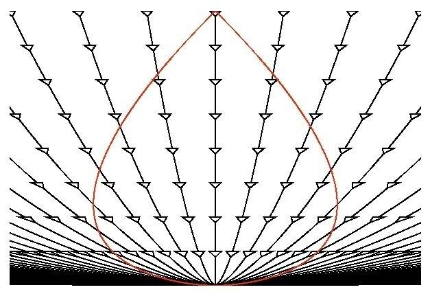

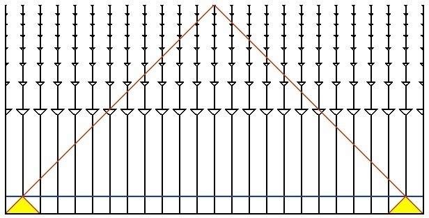

I was reviewing a book I read some time ago "Relativity Visualized" and came to wonder what this means: "a coordinate that's timelike"
In this book, Epstein makes all of his space-time diagrams as "proper-time vs. space" Thus, the equation we're all familiar with
[tex]d\tau^2=dt^2-dx^2[/tex]​
is turned on its head:
[tex]dt^2=d\tau^2+dx^2[/tex]​
Within this context, the (horizontal) x-component represents the position, the (vertical) \tau component represents the age of the particle, and the lengths of arcs represent the actual amount of time passed for a particle from the frame of an inertial observer.
More importantly, the effects of a "stretching" of space-proper-time becomes somewhat visualizable, using one's knowledge of euclidian geometry.
I just thought I would bring this up here, since you said "a coordinate which is timelike," these two "time-like" coordinates, \tau and t, perform differently.
Another question I would ask, though is whether both of them are actually coordinates. The value of the proper-time, \tau actually represents a property of an object passing through the space, while the value of t represents an actual coordinate value in an inertial reference frame. (In tensor lingo, would this be saying that t is contravariant, while \tau is covariant?)
When Epstein works with geometries in [itex](x,\tau)[/itex] coordinates, he seems to be mixing coordinates of different types; a location in space, and a property of a particle at that location. Under this context, he stretches the space-"proper-time" and is able to make quite a few interesting predictions. However, at no point does he actually stretch the coordinate time, t. There's a rule in the book that the length of the paths is equal to the actual time passed, and it seems like he sticks with it throughout.
Is it possible that all of this stretching of space-time in general relativity is actually stretching of (coordinate space, proper time), while it leaves unstretched (coordinate space, coordinate time?)
