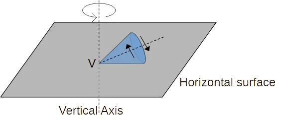

Cone with base r and height h and period for one turn is on horizontal plane and it rotate around vertical axis.
What is expresion for friction force, it is rolling without slipping.
I observe that CM of cone rotate around vertical axis and also cone rotate around axis on which height of cone lies. There is friction force , Fg and normal force.
How to join this two rotations to find friction? If it rolls without slipping , does it mean that all contact points have same magitude of velocity like CM ( it is weird to me because they are on diferent distance form top of cone but they all have sam angular velocitiy). Can I assume that centripetal force equals to friction force for CM?

What is the acceleration of the cone's mass centre? What do you deduce from that?
Would it be different if the cone were mounted on a rotating turntable instead of rolling?

Cone has acceleration because of precession and I can calculate it from angular velocity and perpendicular distance between CM and verical axis .if cone is on rotating turntable iz would just rotate around axis through CM. So CM s velocity will be zero. If it rolls without slipping than contatct point will have 0 velocity with respect to lab frame(vcm=w*r) . I just don t understand what is distance r between that point and axis and through CM and is it needed fora task.
So apply ##\vec F=m\vec a## and consider what can produce that ##\vec F##.

I am puzzled that you keep referring to a contact "point", as though there is only one. The cone is in contact with the plane along a line from its apex to the perimeter of its base.

Possibly something like this...
A solid right circular cone of uniform density has mass m, height h and a base of radius r. ‘V’ is the cone's vertex. If required, use the fact the cone’s centre of mass is located on the cone’s internal axis, a distance 3h/4 from V.
The cone rolls, on its side, on a horizontal surface without slipping such that the cone rotates about a fixed vertical axis passing through V with a constant angular velocity [about the vertical axis] of period T.
Find the frictional force acting on the cone in terms of the given parameters.

so we can find an acceleration of the cone’s centre of mass. Then how to use the non slippery condition?

The question does not involve a non-slippery condition. Or maybe you are referring to @Lnewqban's additional (and pedagogical) question:

The non slippery condition would dictate the path along which the cone rolls. It would also assure us that the motion along that path is maintained by the force of static friction.

The non-slipping condition is simply required to enable the cone to rotate around the vertical axis. Friction provides the centripetal force. On a frictionless surface, the centre of mass would only move in a straight line.
