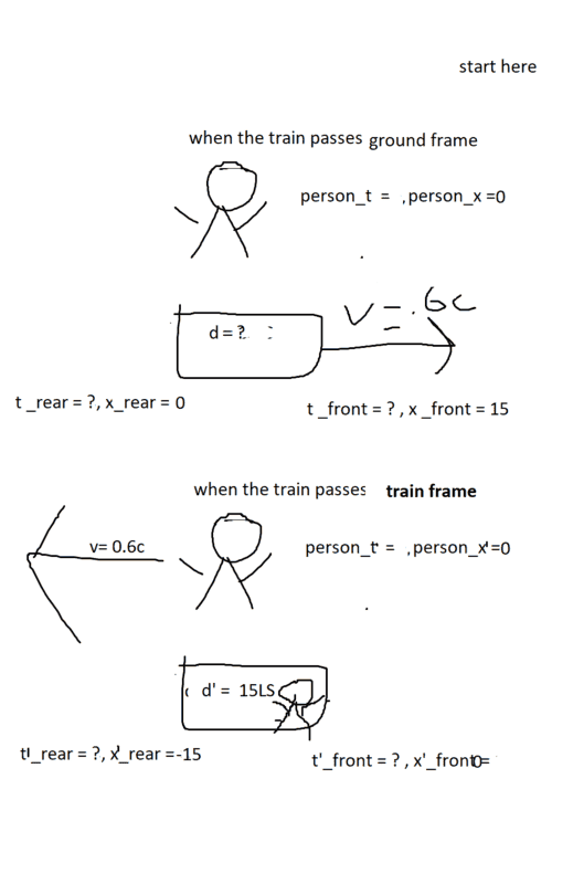

A train with length 15cs moves at speed 3c/5. (1cs is one “light-second.” It equals (1)(3 x 10^8 m/s)(1 s) = 3 10^8 m.) How much time does it take to pass a person standing on the ground, as measured by that person? Solve this by working in the frame of the person, and then again by working in the frame of the train.
##gamma = \frac 1 {\sqrt {1 - \frac {v^2} {c^2}}}##
Because the book doesn't have an answer. Can someone confirm if I am correct?
The question can be found on page 49 of the link below.
I added arrows to the picture just to separate the equations not to say greater then.

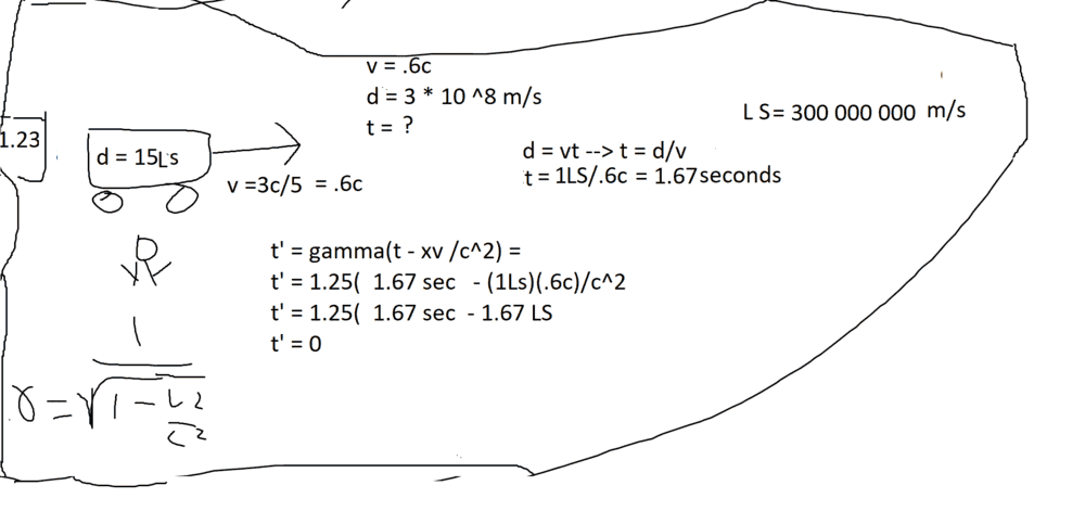

Next calculate in my frame
## v = .6c ##
## d = 3 * 10 ^8 m/s ##
## t = ?##
I want time
##t = 1.67##
I plug the numbers into the Lorentz transform for time to get the moving frame
I get t' = 0.
So the answer are t' = 0 and t = 1.67.
Let's start with the cs unit. It is the distance by which light travels in one second. If light travels 3×108 meters in one second, it will travel the length of the train in 15 seconds. How many meters is that?
To find how long it takes the train to pass the person on the ground, I suggest that you first figure out how long the train is from that person's point of view. Then divide that length by the speed of the train.
Do you really believe that in the train's frame of reference, a train that is 15cs long passes the person on the platform in zero time? If you assume that the front of the train passes the person at t' = 0, you must find the time t'' at which the end of the train passes the person. Then t'' is the time you are looking for.

What is really confusing me is what is the initial position and time of both ends of the train and the initial position and time of the person standing still. Can you help with this question? Well I guess I can just assume t = 0 x = 0 for stationary person.
OK, d = 3 x10^8 m is the distance that light travels in one second. How is that relevant to this problem?
gtguhoij said:
What is really confusing me is what is the initial position of both ends of the train and the initial position of the person standing still. Can you help with this question?
OK, say the person at t = 0 is at x = 0 in the rest frame of the platform and that the front of the train at rest is also at x = 0. Where do you think the end of train is if the train is 15cs long? You are free to choose the origins at t = 0 and t' = 0 however you please, but the usual formulation of the Lorentz equations assumes that at t = 0 and t' = 0 the origins coincide, i.e. x = 0 and x' = 0.

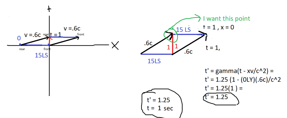

I drew a spacetime diagram I got t = 1 sec and t' = 1.25. Is this correct now? I also forgot the units in the graph for time. It is seconds
It is not correct. How can a train that is 15cs long pass by the person on the platform in 1 s? To do that, it must travel faster than the speed of light. Not possible. You don't need spacetime diagrams to do this. I offered you suggestions which you ignored so far. I will try one more time and then I'll quit.
Imagine being a person on the platform. When you see the front of the train pass by you, you start a clock running. When you see the back of the train pass by you, you stop the clock. The train is moving at 0.6c. What does the stopwatch read? If you cannot answer this relativistically, consider first a non-relativistic warm up problem:

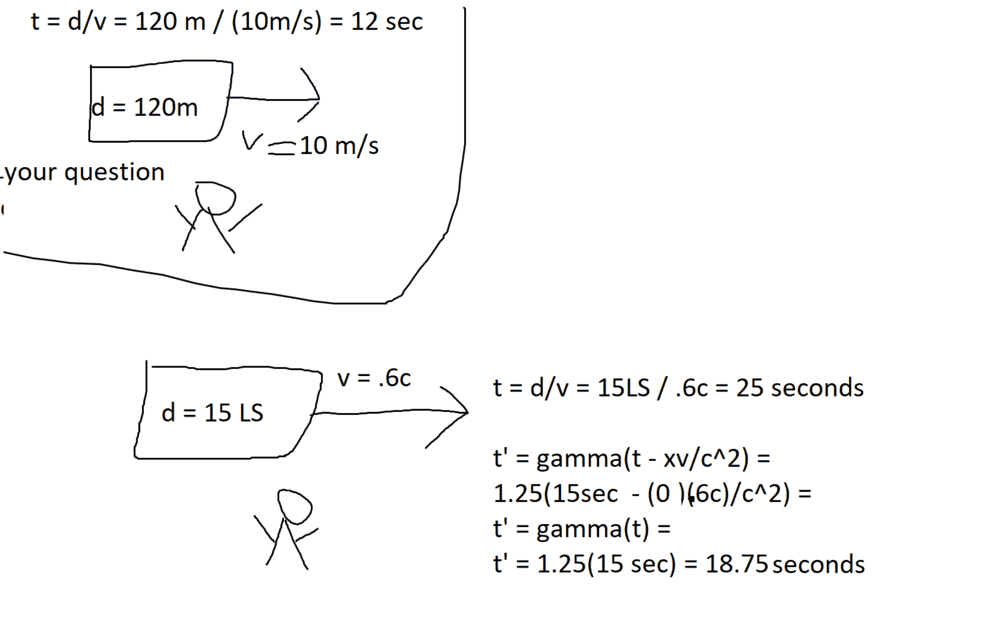

Non-relativistic problem
A freight train is 120 m long and travels at 10 m/s. How long does it take to go by a person standing near the tracks? The strategy for answering this is the same as the strategy for the relativistic case and should get you started.
Here is my attempt. I first did your question The answer I first got was t = 12 seconds.
Then I did the problem above. I got t = 25 seconds. I am not sure if I need to use relativity of simultaniety for the time in the stationary person frame. Do I ? Then I calculated the time in the train frame. The answer I got was t' = 18.75 seconds. I think this reduces to t' = t gamma because x = 0. Did I make any mistakes? What would a spacetime diagram look like?
The non relativistic answer is correct. The equivalent relativistic calculation in the stationary person frame is not. Do you understand length contraction? The 15cs is the length of the train as seen by an observer that moves with the train. Will the stationary person see the same length? If not (the answer is not) what length does the person on the platform see?
I think so. I assumed the value 15LS is already the contracted length. I guess I was wrong. I assumed L' = 15 LS was L = 15LS. The definition is moving objects are length contracted.
Unless otherwise stated, the length of an object in special relativity problems is the proper length. Thus, the 15cs is the length according to the train engineer. So what is the length of the train as measured by the person on the platform?

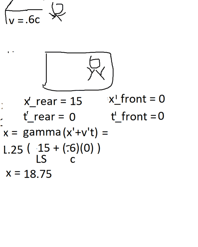

Here is my attempt.
I have velocity = .6c and d' = 15LS.
t' = d'/v = 25 Seconds
x = gamma(x'+vt')
x = 1.25 (15LS + (.6c)(25 Seconds) ) =
x = 1.25 (15LS + 15LS) =
x = 1.25 (30LS) =
x = 37.5 LS
Is this correct? Or should x' = 0?
After thinking about I think x ' = 0 let me correct the answer.
x = gamma(x'+vt')
x = 1.25 (0 + (.6c)(25 Seconds) ) =
x = 1.25 (0 + 15LS) =
x = 1.25 (15LS) = 18.75 LS
x' denotes the coordinate where an event occurs as seen in the primed (moving) frame. It could be zero depending on the event that occurs. For example, if the event is the front of the train being at the origin at time ##t'=0##, then ##x'_{\mathrm{front}}=0##. Since the back of the train in the moving frame is ##L_0 = 15~\mathrm{cs}## behind the front, then at ##t'=0## you have ##x'_{\mathrm{back}}=-L_0.##

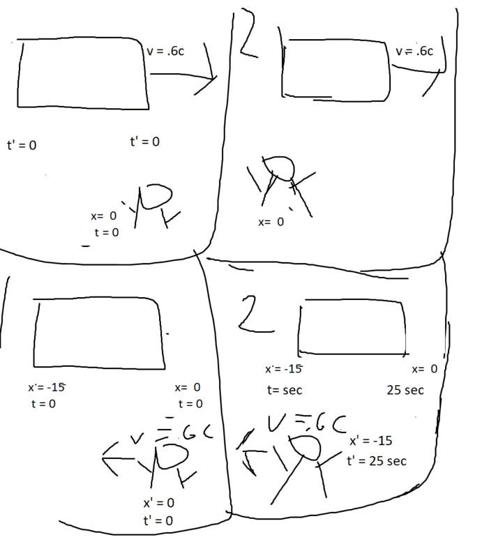

Here is my thought process.
How do I figure out the distance for an person on the ground frame? I use the fact that moving clocks move slow. So I try the equation x′=gamma(x+vt).
But I don't have time of the rear clock.
Then I try to calculate trear=dv. trear=.6c. I know this is wrong because t isn't ′t=0 . Also the same logic can be applied to x_rear.
So I decide to switch frames
I discover xrear=−15LS I have no idea why xrear=−15LS. I use the fact that moving clocks move slow. So I try the equation
t=gamma(t′−x′vc2)=. But since I don't have time I calculate time' using ## t'_{rear} = \frac {d′] {v} = ##
−15LS−.6c=2.5seconds

Event 1 - the front of the train passes the stationary observer.
Event 2 - the rear of the train passes the stationary observer.
So far we know the following for Event 1:
##x_{\text{front,1}}=0~;~~t_{\text{front,1}}=0~;~~x'_{\text{rear,1}}=-L~;~~ t'_{\text{rear,1}} =0.##
You can use the Lorentz transformation (as you tried to do) to find the the position of the rear in the stationary frame. The correct calculation is
##x_{\text{rear,1}}=\gamma(x'_{\text{rear,1}}+vt'_{\text{rear,1}})=\gamma(-L+0)=-\gamma L##.
Since ##\gamma > 1##, you might jump to the hasty conclusion (as you seem to have done) that this means that in the stationary framer the train is longer than its proper length L. That would be true if the rear of the train were at that distance at time ##t_{\text{rear,1}}=0.## But ##t_{\text{rear,1}}\neq 0## and you need to find it.
The problem is asking you to find ##t_{\text{rear,2}}## which is the time in the stationary frame at which the rear passes by the observer. I will give you a generous hint. In the stationary frame ##\Delta x_{\text{rear}}=v\Delta t_{\text{rear}}~~\Rightarrow~x_{\text{rear,2}} -x_{\text{rear,1}}=v(t_{\text{rear,2} }-t_{\text{rear,1}})##. Figure out which quantities in the last equation you already know and which you can find out and then solve for ##t_{\text{rear,2}}.##

To get ##delta ~ t_rear## I go ##t ~ rear ~ 1 - t ~ rear ~ 0##. To get ##delta ~ x ~ rear## I go ## x ~ rear ~ 1 - x ~ rear ~ 0##.
I currently have delta ##t~ rear## in the spaceship frame. I need ##delta t'~ rear## for the person on the ground frame. I can get this by using the Lorentz transform. Then I repeat the process above except in the non prime frame.
I think the exact numbers are ## delta ~ t~ rear = -25 sec ## This is because v = .6c and x'~ rear = -``15 in the equation.
Can I use a delta Lorentz transform or only event 1 at a time?
##delta~t~rear~ ##
Assuming I can't I will just do it the long way
## t' = gamma (t - \frac {x v} {c^2})##
## t'~ rear ~ 0 = 1.25 (0 - \frac {-15LS .6c } {c^2}) = 1.25 (9) = +11.25 sec ##
## t_rear_1' = 1.25 ( -25 sec - \frac {-15LS .6c}{c^2} ) = 1.25 (-16 secs) = -20 sec ##
## delta t = t1 - t0 ##
## delta t = (-20 sec) - (+11.25 sec) = -31.25 ##
