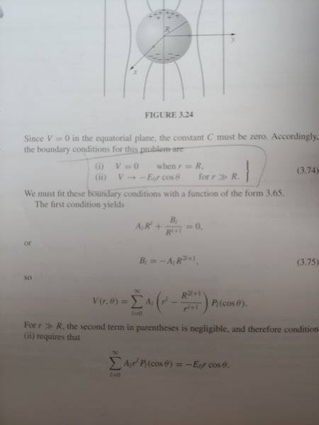

In the textbook (attached image) it says that the boundary condition is V=0 at r=R.
This creates a correlation that
##B_l=-A_l R^{2l+1}##
but the potential at any boundary is continuous so when we take this account, we get.
##B_l=A_l R^{2l+1}##
These two clearly contradict each other. I'd like to know why this contradiction occurred.
Many thanks.

I think you are ignoring the possibility of an ## l=0 ## solution. ## \\ ## You then have a separate solution inside the sphere that says ## V=0 ##, that has both ## A ## and ## B =0 ##. ## \\ ## The coefficients of ## A ## and ## B ## inside the sphere are different from what they are outside. The potential ## V ## is continuous across the boundary, but that doesn't mean that each of ## A ## and ## B ## stay the same. ## \\ ## Your first equation is correct, but for this case (## r \geq R ##) you only have the ## l=0 ## term. I'm not sure how you came up with your second equation. ## \\ ## You really need to label the coefficients ## A_{l \, out} ##, ## B_{l \, out} ##, ## A_{l \, in} ##, and ## B_{l \, in} ##. ## \\ ## Edit: I looked at it a second time=I misread the problem. I thought ## V=0 ## everywhere at ## r=R ## . Let me try again... It would help if you could show us the previous page, because otherwise it is a guessing game of what we are trying to solve.

Does the textbook also tell us what A and B are ?
I can't really see, the picture is so vague :mad:

How so ? can you elaborate ?
Since the term ##r^{l}## diverges as r>>R, it is not considered at r>R, similar logic was also applied for ##r^{-l-1}## for the case inside the sphere.
Since both terms should have the same value at r=R (since the potential is continuous at any boundary) the terms ##A_l R^{l}## and ##B_l R^{-l-1}## should have the same value, hence the correlation mentioned above.
However, if we consider the potential inside (and on the surface) of the potential to be 0 and we plug r=R into the original equation ##A_l R^{l}+B_l R^{-l-1}=0## the rest of the boundary condition would be the same, which means we would get two different answers for the boundary condition that doesn't seem to contradict each other.

But in the textbook it said that there are no terms ## A_{l \, out} ## and ## B_{l \, in} ##, since they diverge at the points relevant to them.

I can believe that, but if I don't see the previous page, I don't know exactly what the problem consists of. ## \\ ## e.g. What is the constant ## C ##? I shouldn't need to guess what they are referring to.

The constant is from the equation
##V=-E_0 z+C## for ##r>>R##
And the question was for a uncharged metal sphere of radius R that was placed in a electric field ##E_0## (which was taken to be the direction of z), find the potential outside the metal sphere. (Since the induced charges inside the sphere ball would distort the field/potential around it)
You might want to try a different source and compare what they both get for the same problem. The other source may also have an improved explanation. Try https://nptel.ac.in/courses/115101005/downloads/lectures-doc/Lecture-16.pdf
At the top of page 2 he talks about ## B_o =0 ## unless there is a charge on the sphere, as he mentions in the last sentence at the bottom of page 2.
