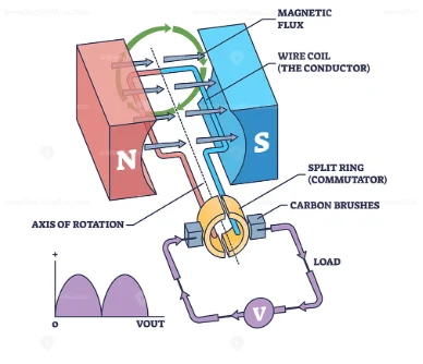

Why does a rotating wire in a magnetic field only cause a current within that wire
So Faraday's Law of induction states this: $$ \nabla \times E = - \frac {\partial B} {\partial t} $$
Or if we write it in it's integral form: $$ \int E \cdot dl = - \frac {d \Phi_B} {dt} $$ which (to my understanding) means that the magnitude of the EMF around a coil of wire will be equal to the magnitude of the change flux through that wire. I get confused in some cases as when we have a generator like this:
Nowhere in the region between the 2 magnets is the field actually changing, so (with my limited understanding) no electric field should be generated.
If we make the coil stationary and rotate the magnet instead, everywhere in between the magnets is experiencing a change in flux, so everywhere should have an electric field, but one is only generated within the wire
So what is wrong with my understanding?
That is correct. The EMF in the wire is not due to an E field. The EMF in the wire is due to the Lorentz force on the charges in the wire.

It can be slightly different because in one case an accelerometer will detect that one is accelerating and in the other case the other will be accelerating. Rotation is non inertial.
To understand how an experiment or device works you need to consider Maxwell’s equations in a reference frame that is inertial, meaning it is not itself accelerating or spinning.

This is about the amount of magnetic flux going through the open loop of the rotating wire. That is changing as the wire rotates. With the wire loop oriented as shown in the diagram, no flux passes through it. When the wire loop rotates, that changes to a maximum flux through the loop when it is oriented vertically.

But ##\Phi_B = \int \int_\Sigma {\vec B \cdot d\vec S}## changes over time, because the angle between the magnetic field and the normal to the rotating surface changes over time.
##\Phi_B (t) = SB \cos {(\omega t + \alpha})##, where ##S## is the area of the loop.
##EMF = - {d\Phi_B \over dt} = SB\omega \sin {(\omega t + \alpha)}##
