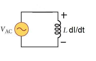

Sorry everyone, I have been away from this thread for a very long time, what with quizzes and exams being held almost everyday, at the university, and also due to some other circumstances. :frown: Well anyways, I am finally back here, and am surprised that this thread has not been closed yet. :bugeye: And so, I would like to thank the admins for this.
@sophiecentaur. I think I understood the analogy for back emf: that, for the same back emf, the one with higher inductance will show a less change in current, compared to the one with low inductance showing a greater change in current. And that, for the limiting case of infinite inductance, the change in current will be zero. Right?? But, what I wanted to know was about the equation ø = L I, and L = ø / I. Here for L to be infinite, I has to be zero, irrespective of the value of ø. Which seems to mean to show that for infinite inductance, L , any magnetic flux, ø seems to be produced from zero current, I. Right? And, I think I understood that the back emf was the voltage drop across the inductor itself, i.e. L dI/dt, which is obviously equal to the supply voltage, VAC, as seen from the picture. Am I understanding it right?? Would anyone kindly verify. :smile:
  • Circuit schematic: an AC voltage source V_AC on the left in series with an inductor L on the right, labelled L dI/dt, with plus and minus signs marking its terminals.
Please. May I have some help here, in clearing this thing out. @sophiecentaur

Start from the basics: The magnetic field of a coil is B=μNI/l and Amper's Law: The change of the flux Φ produces back emf in a coil: emf= -dΦ/dt. Φ= B A, emf= -μNA/ldI/dt. L is defined as the coefficient of dI/dt, so you have the equation of the back emf : emf= -L dI/dt.
If you have a loop with an ideal ac generator with emf E=E0cos(ωt) and an ideal inductor with inductance L, E-LdI/dt=0 according to Kirchhoffs Law. So dI/dt = E0/L cos(ωt) and integrating, you get I=E0/(ωL)sin(ωt) +C. Initially the current is zero, so C=0 and I=E0/(ωL ) sin(ωt)
The current is a sin function, lags the voltage by 90° and has the amplitude of E0/(ωL ). It is not zero.
ehild

Thank you, and I think I have already come to that conclusion, in a recent post. That, the back e.m.f. is actually a manifestation of the drop of the supply voltage across the inductor, and as such is equal to the supply voltage, with the current lagging behind the voltage by 90°. But, another question that just came to mind is that, while the back emf is equal to supply voltage in magnitude, for an inductor, is it in-phase or out of phase by 180°, to the supply voltage, for an inductor, and consequently for the primary side of the ideal transformer in no-load condition. For I have read that in that case, the back emf although equal, is out of phase by 180° to the applied voltage.
Yes. That's why it is called 'back' emf; it subtracts from the supply voltage and, in a good transformer, it produces a very small net voltage.
Thank you very much. I think I get it now. But if there is any other problem I will just post it here. Thanks again.
