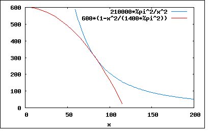

If you plot [tex]\sigma[/tex] against l/r, you will be plotting the inelastic buckling load, since buckling occurs when the column reaches its yield stress, [tex]\sigma_{y}[/tex]. This is true up to the critical l/r ratio, (l/r)c.
At this point, the column is considered long, and buckling will occur before the yield stress is reached. From this point on, Euler's buckling formula takes over, and increasing the yield strength of the column will not affect the buckling load.
Thus the complete column buckling load / stress is depicted by two functions, sigma(x) and Euler(x), where x represents the l/r ratio. The former applies for l/r from 0 to 83, and the latter applies for x(=l/r) = 83 and higher. The transition between the two curves is smooth, since by substituting the critical l/r into the parabola (sigma(x)), we get exactly [tex]\sigma_{y}[/tex]/2 for both formulas.
Here is a plot of both curves.
Note that the transition is at l/r (=x) of 83, and 600 on the y-axis represent the yield stress of 600 Mpa.

Does it look pretty much like the one shown in post #6 above?
If they don't cross, there is probably a little problem, as they are supposed to be tangent to each other.
It doesn't look right. The transition point should be tangential to each of the two curves, and should not cross. Could you check the formula, especially that of the blue curve?
Do you come up with the same formula as mine, which is indicated on the top right of the graph? The constants may be different, but the formula should be similar.

The graph looks right, but I'd like you to calculate, if possible, the tangent point to make sure that they don't cross. I seem to see that they cross some how, but it could be an optical illusion.
Excellent work, I am glad that you cracked it!
