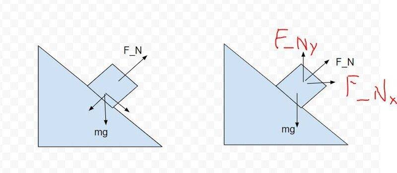

When we take the x-axis parallel to incline surface its clear that the horizontal component of weight is causing the block to come down but when we take the standard orientation its not so clear to me. Is horizontal component of ##F_N## causing the block to come down?

The acceleration is along the incline, perpendicular to ##F_N##. So: no.
The force that causes the block to come down is the component of ##mg## that is along the incline.
The other component of ##mg## is offset (compensated) by ##F_N##.
You need to write out the magnitudes of the components. What do you get for F_Ny and F_Nx? You should find expressions containing mg, and sines and cosines of the incline angle.
This gets messy but you need to do it, in order to understand why incline problems are always solved using the parallel and perpendicular axes (as shown on the left). The answer has to come out the same either way, but one way is much easier.

Well, first of all, any horizontal direction is always perpendicular to ##m \vec{g}##, by definition. For example, a plumb bob points in the direction of ##m \vec{g}##. A carpenter's level is oriented in a horizontal direction when the bubble is in the middle.
We typically choose the x-axis to be parallel to the surface of the ramp. We do this so that the block's acceleration will have a zero component in the y-direction.
If instead you choose the x-axis to be horizontal (what you are calling the "standard orientation") then the acceleration will have generally nonzero x- and y-components. When you follow the scheme outlined by @gmax137 in Post #3 you will have values for ##a_x## and ##a_y##, the perpendicular components of ##\vec{a}##.

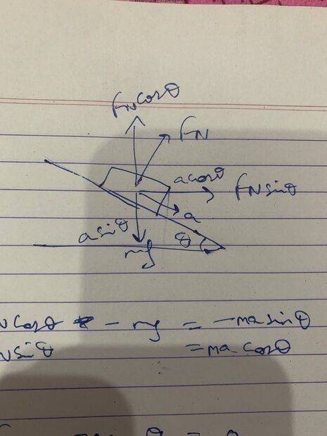

The eqns are ##F_N\cos \theta-mg=-ma\sin \theta##
##F_N\sin \theta=ma\cos \theta##.
I understand that it’s easier when one of the components of a is zero.
But my main confusion is with ##F_N##. As the previous post suggest it’s not responsible for the acceleration of the block since they are perpendicular to each other.
But if we take the horizontal and vertical axis and resolve components then we can see one component of acceleration is in direction of one component of normal and other component of acceleration is parallel to mg. So are both the forces normal and mg together causing the acceleration down the incline?

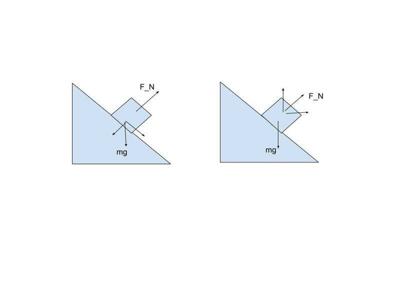

Why? Isn’t the resultant of ##F_N \sin \theta## and ##mg## causing the acceleration down the incline?

No. ##F_N \sin\theta## is not in the direction of the incline.
The component of ##F_N \sin\theta## that is along the incline is ##F_N\sin\theta\cos\theta##.
But then so is the component of ##F_N\cos\theta## that is along the incline: ##F_N\cos\theta\sin\theta## and that is pointing in the opposite direction, nicely canceling. In short:
##F_N## has NO component along the incline. Period.

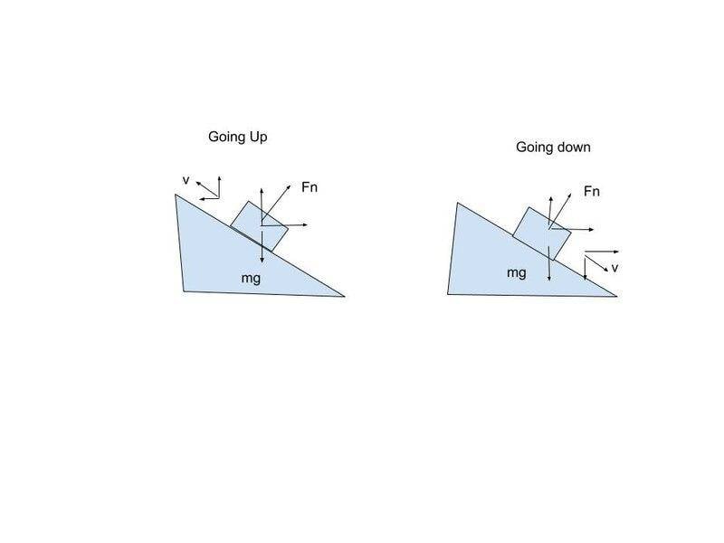

See in this post using the horizontal as x-axis both the weight and normal force components are playing a role in slowing the block down. So why not here the normal force and the weight together causing the block to slide down?

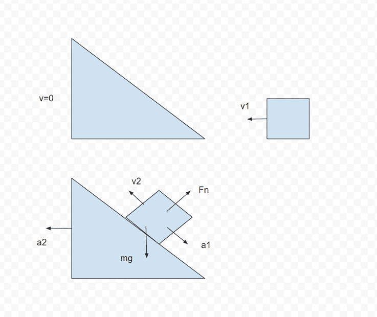

If in that thread components of normal and weight are causing the block to slow down then why not in this thread helps to accelerate it down the incline?
You forget that the acceleration is related to the net force. In this example the net force is equal to the tangential component of the weight. This is so no matter how you choose the axes.
In other problems the net force may have a different direction, even though there is an inclined plane involved.
In that problem the incline was moving, here it is stationary. It would be silly to expect to see no difference, assuming that what you say about that one is right.

And for that problem with moving incline it’s the same three forces slowing the block as here accelerating the block. I got confused. But now I got it.
rudransh verma said:
Ok! So you mean I forgot about the angle of vector acceleration. That first relation is true for any angle. But to keep the body on the plane we need to have an angle that makes same angle with horizontal and vector and incline. So in a sense the net acceleration vector is the constraint. Right!
In that problem the constraint is different. As the incline moves too, the relationship between the components of the acceleration of the block is different in the frame attached to the ground.
