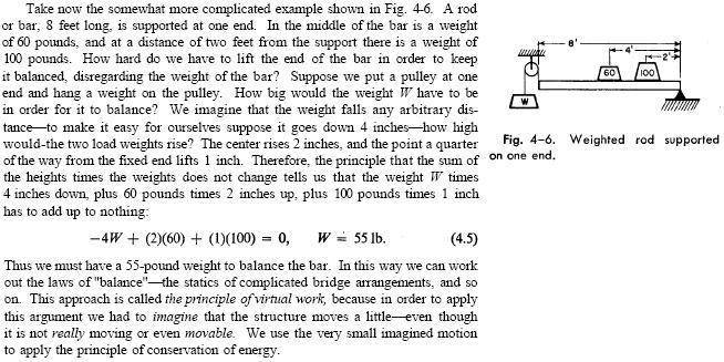

Hi,
I've been reading chapter 4 in the Feynman Lectures on the conservation of energy and I've bought a book off amazon called Exercises in Introductory Physics which accompanies the series. Having looked at some of the questions I feel well out of my depth because essentially I haven't ever really done any problem solving. I have got A-level maths but that was years ago. The question I'm stuck with is the first one on the CoE. It goes like this:
1. Use the principle of virtual work to establish the formula for an unequal-arm balance:
W2L2 = W1L1Neglect the weight of the bar.
The diagram is basically a see-saw with a weight hanging from either end of the bar. The distance to the fulcrum of L2 is > L1's.
How do people approach things like that? What are your thought processes? I thought the answer would be the formula stated and you just rearrage to find an unknown.
I think I understand the theory and when I read the notes I follow everything and understand it but as soon as I get a problem I just go blank and get frustrated! :confused:
Hope someone can help set my mind free for problem solving.
Thanks
Mark

Thanks again for the responses. It's funny how you can lose the plot with things sometimes by focusing on one little but. The whole sub title of the section is Gravitational Energy so the I guess the clue is in the title. I've attached a copy of the section of text I've been mulling over trying to solve this.
Is it as simple as this: W2.H2-W1.H1=0?
From this if you plug numbers in, you can work out the various heights etc each arm has to move for the total to equal zero even if you move the fulcrum about and also obeying the conservation og energy laws.
Anywhere near?!

How about now for the attachment?

oooh yes, that's definitely an attachment! :biggrin:
