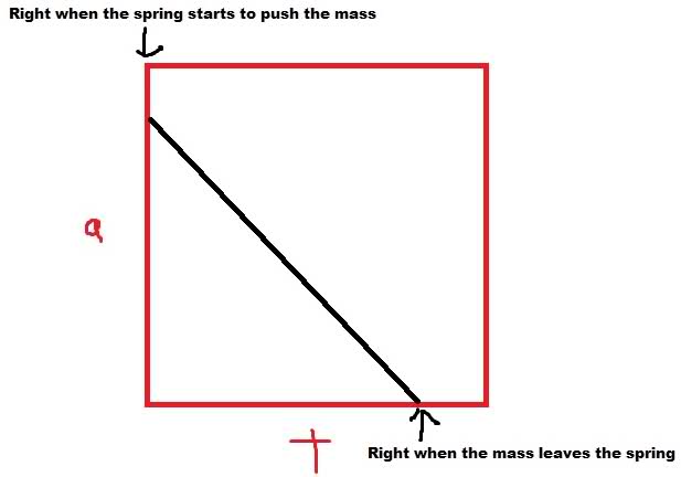

The last part of this practice question want's to know when this max acceleration occurs.
That's going to be when the spring reaches equilibrium correct?

No, to the contrary.
Are you mixing acceleration and velocity?
Remember that you calculated a speed v=2.98 m/s!
Note that a=F/m.
When is F at its maximum?
Is this the idea then?
Depends on what you have on the x-axis.
Is it x or t?
It should be x.
I was thinking of it's acceleration vs time, but vs distance might be more appropriate yes. Either way, that would make the max acceleration occur right when the spring starts to expand back to it's equilibrium state correct?
Good! :smile:
FYI, acceleration vs time is a cosine.
I like Serena said:
Good! :smile:
Because that is modeled by a simple harmonic motion right?
Yep! :approve:
