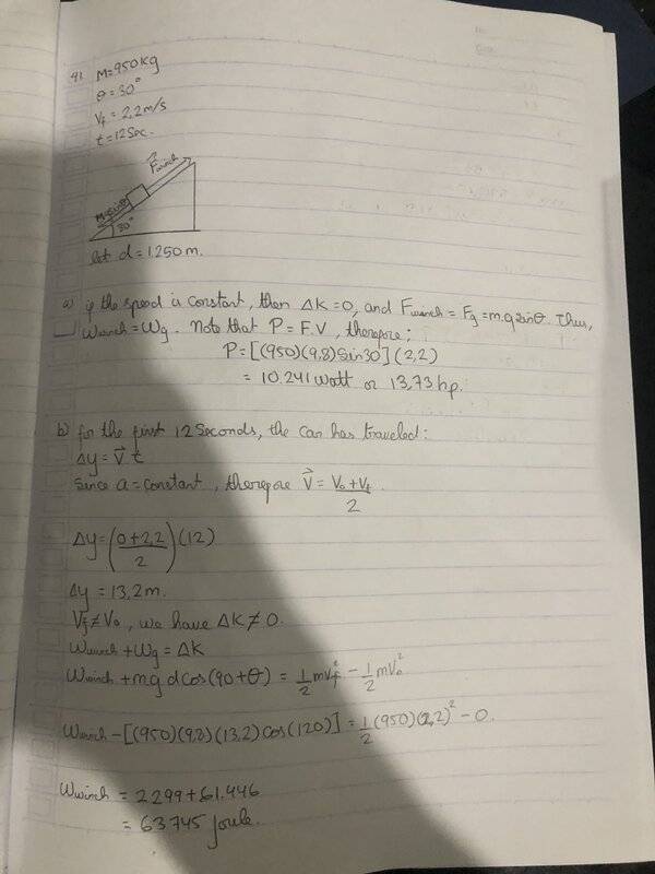

A loaded ore car has a mass of 950 kg and rolls on rails with negligible friction. It starts from rest and is pulled up a mine shaft by a cable connected to a winch. The shaft is inclined at 30.08 above the horizontal. The car accelerates uniformly to a speed of 2.20 m/s in 12.0 s and then continues at constant speed. (a) What power must the winch motor provide when the car is mov- ing at constant speed? (b) What maximum power must the winch motor provide? (c) What total energy has transferred out of the motor by work by the time the car moves off the end of the track, which is of length 1 250 m?
E=K+Ug
P=F.V
y=V.t
W=P.t

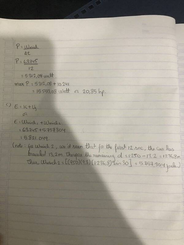

Hello there,
I was trying to solve this problem. I have no problem with part A and C. But in part B, my guidebook arrived with different answer. Can anybody point out what my mistake is? I am using the same method as the elevator motor problem which states :
"A 650-kg elevator starts from rest. It moves upward for 3.00 s with constant acceleration until it reaches its cruising speed of 1.75 m/s. (a) What is the average power of the elevator motor during this time interval?"
My second question is, why can't I use the same method with this problem? I mean it basically has the same "situation" right?
Your answer to a) is about ##10kW## and your answer to b) is about ##15kW##? But, for b) the only difference is a small acceleration (much smaller than the gravity down the slope). The answers to a) and b) should be not that much different.

Your answers to a) and c) look very good: nice and short. The answer to b) should be nice and simple too!

Transcribing your answer so that I can read and understand it. I will add a few minor fix-ups.
chicken scratchings said:
b)
For the first 12 seconds the car has traveled ##\Delta y = \vec{v_\text{avg}} \Delta t##
Since a = constant, the [garbled] is ##\vec{v_\text{avg}} = \frac{v_o + v_f}{2}##
##\delta y = \frac{0 + 2.2}{12}##
##\delta y = 13.2m##
One notes that you have not yet laid out a coordinate system. But it seems that you want the "y" axis to run diagonally along the length of the track. So "y" is the along-the-track distance the car has moved in the first 12 seconds. So far, so good, I am in agreement that the cart travels 13.2 meters in 12 seconds for an average velocity equal to half of the final velocity.
##v_f## is not equal to ##v_0## so we have ##\delta K## non-zero.
Here, you are using ##K## to denote kinetic energy
I tend to be a nit picker when it comes to declaring your variables before use -- computer programmer by trade
$$W_\text{winch} + W_\text{g} \Delta K = \frac{1}{2}mv_f^2 - \frac{1}{2}mv_0^2$$$$W_\text{winch} + mgd \cos{90 + \theta} = \frac{1}{2}mv_f^2 - \frac{1}{2}mv_0^2$$
Next, you start plugging in numbers before having solved the equation. That is poor strategy, though it will work. Solving the equation symbolically first is easier, less prone to error and may allow you to cancel common factors
$$W_\text{winch} + (950)(9.8)(13.2)]cos{120} = \frac{1}{2}(950)(2.2)^2 - 0$$
Here I am not pleased with the cosine of 120 degrees. The angle is 30.08 degrees, not 30 degrees. You do not round off for significant figures until you are done with your calculations and are reporting a finished result.
Personally, I would have used the sine of 30.08 degrees and inverted the sign on the term. But I see what you are doing. You are taking your angle with reference to a base zero angle pointing directly down. 30 degrees above the horizontal is 120 degrees above the zero angle and the work due by gravity will pick up a negative sign for such an angle due to the cosine going negative.
Second I would have expressed it as the sine of 30.08 degrees and negated the sign on the term.
##W_\text{winch} = 2299 + 61446##
##W_\text{winch} = 63745##
##P=\frac{W_\text{winch}}{\Delta t} = \frac{63745}{12} = 5312## Watt
So you have total energy expended during the 12 seconds and you divide by the 12 seconds to get average power. That looks good.
But what comes next does not follow. You add steady state power after the first 12 seconds to average power during the first 12 seconds to get maximum power at the end of the first 12 seconds.
What is the motivation for this computation:
Max P = 5312 + 10241
It is extremely tedious to transcribe stuff this way. We should not be forced to do it. That's your job.
Here's a quick answer to part c):
The work done is KE + GPE gained. KE is ##\frac 1 2 m v^2## and GPE is ##mgh = mgl\sin \theta##. The KE term is negligible compared to the GPE term. With ##\sin 30 = \frac 1 2##, we have
$$W \approx \frac 1 2 mgl = 5.82MJ$$
What is the motivation for this computation:It is extremely tedious to transcribe stuff this way. We should not be forced to do it. That's your job.
I see, so the final part is what I did wrong. For the angle, I missread it, I missed the .08, my bad. For the final computation, I add those 2 powers, because I was imagining that the winch is exerting power on the cart for about 5312 watt for the first 12 seconds to get it to accelerate to the final speed, and then it exerts another 10241 watt for the rest of the motion. So I thought the max power should be the sum of those 2. But I was not really sure.
Your 63745J is the work done in the first 12s (I make it a bit more). So when you divided by 12s you got the average power for the first 12s.
By what logic would you add to that the power at constant max speed?
The acceleration in those 12s is constant. What relationship would you expect between the average power over that time and the peak power?
Are you sure it is 30.08 degrees? Are you perhaps misreading a badly written/typed o as 8?
I see, so the max power is not the average power of the first 12 sec plus the power at constant max speed. Wait a minute, so the max power is the power at constant max speed plus the force times final velocity (which is the "extra power" needed to just accelerate the block at the first 12 sec, and not the full average power for the first 12 sec?) which is approximately 10.6 kW. Am I getting this right?
P.S. I have rechecked, I mistyped, it should be 30.0 only, not 30.08, and by 10.6 kW, I mean the whole max power, not the "extra power" for the first 12 sec.
Not sure which force you mean. If it's the extra force to provide the acceleration then yes.
Yes.
Note that it is double the average power over the 12 sec, just as the final speed after constant acceleration from rest is double the average speed.
This is one of the problems with the plug-and-chug method you've no doubt been taught. As soon as you plug the numbers in you lose sight of the physics. Take a look at the equation: ##P = Fv##. If force is constant, then power is proportional to velocity (for simple accelerated motion at least). That means that:
$$P_{avg} = Fv_{avg} \ \ \text{and} \ \ P_{max} = Fv_{max}$$
Which is a useful observation, and only comes if you resist the urge to plug in the numbers at the first opportunity.
Yes.
yes, I mean the extra force to provide the acceleration. Thanks a lot man, now I understand
ah yes, it is a bad habit of mine. Back when I was in college I did that a lot (I am a Management major though) I study physics by myself, so nobody taught me
