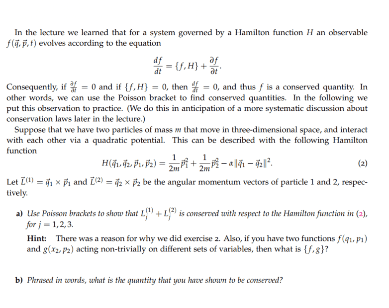

Show that ##L_j^{(1)}+L_j^{(2)}## is preserved
See screenshot

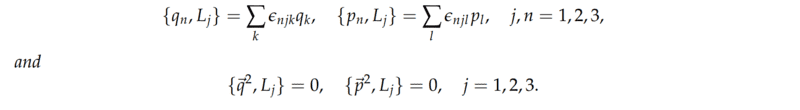

Results from the previous task, which we may use
Two equations: the Poisson bracket of q_n with L_j equals the sum over k of epsilon_njk q_k, and the bracket of p_n with L_j equals the sum over l of epsilon_njl p_l, for j, n = 1, 2, 3; followed by the brackets of squared q-vector and squared p-vector with L_j both equal to zero for j = 1, 2, 3.
I am unfortunately stuck with the following task
Typeset lecture text on Hamiltonian mechanics: df/dt = {f,H} + ∂f/∂t, Hamiltonian H for two particles with quadratic potential, and Poisson bracket exercise on conserved angular momentum.

  • Typeset lecture text on Hamilton functions and Poisson brackets, with equation (2) for two particles coupled by a quadratic potential, and parts a) and b) asking for a conserved angular momentum quantity.

  • Typeset lecture text on Hamiltonian mechanics: df/dt = {f,H} + ∂f/∂t, Poisson bracket conservation statement, two-particle Hamiltonian H(q1,q2,p1,p2) with quadratic potential, and parts a) and b) of the exercise.
