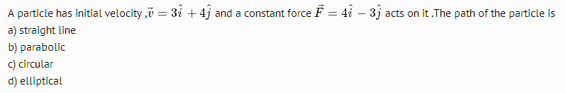

Multiple-choice question: a particle has initial velocity 3i + 4j and constant force 4i - 3j; options: a) straight line, b) parabolic, c) circular, d) elliptical.
If I consider a coordinate system with the -Y axis along the direction of force and X axis along a line perpendicular to it (except the direction of velocity vector) then this problem is equivalent to the usual projectile motion problem where a particle is projected from an elevation horizontally ( i.e velocity perpendicular to gravity ) .
So I can conclude that the path in the problem is parabolic i.e option b) which is indeed the given answer .
Now , when I tried to find the equation of trajectory , I am a bit lost .
In the usual X-Y coordinate system with 'm' representing the mass of the particle , we have ,
## x = 3t + \frac{1}{2}\frac{4}{m}t^2##
## y = 4t - \frac{1}{2}\frac{3}{m}t^2##
I am finding it difficult to solve the above equations so as to get the relation between x and y .
Any sincere help is very much appreciated .
Thanks .

Calculate ##3x+4y## to eliminate the quadratic terms in ##t##. Then solve this for ##t## and substitute for ##t## in either ##x(t)## or ##y(t)##. You should get a parabola tilted at 45 degrees.

But on expanding I get a term containing ##xy## . I have never really seen an ##xy## term in the usual parabola equations .

The coupled terms like that in conic sections such as parabola is an indication that this curve is rotated at an angle from ##x## or ##y## axis.
