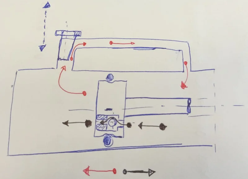

Sure. But first, you need to show us exactly what you are trying to do. This requires a sketch. The sketch does not need to be a detailed engineering drawing. A simple pencil sketch that shows your concept is normally enough. Designs that look similar can have either laminar or turbulent flow, which makes a large difference in the calculations and the damping.
You need to specify what type of fluid because you mention both hydraulic oil and air in your OP.
I’ll try to attach a sketch.
It’s the simplest one I could think of, but it does represent what I’d like to model in physical terms. It shows a hydraulic circuit set in motion by an external force (spring, motor or ‘human power’).
By pulling the piston to the right, I move the fluid from the right chamber to the left one via the non-return valve on the piston (black path); conversely, by pushing the piston to the left, I move the fluid from left to right via the control nozzle (red path).
Obviously, the valve and the nozzle have different cross-sections and consequently the resistance coefficient is different. When the cylinder is pushed, the check valve is closed and so the fluid is forced to pass through the nozzle; when the piston is pulled, the fluid passes through the valve and not through the nozzle because of lower hydraulic resistance.
The fluid is hydraulic oil, and the question I would like to ask is how to evaluate the hydraulic resistance as a function of the variation in the nozzle cross-sectional area (velocity damping), and also to study this variation based on the flow cross-sectional area of the valve located in the piston.
I hope I have made myself clear and I have attached a very simple sketch. I hope it will be of help.

Is this an existing physical piece of equipment that you can perform experiments on, or is it a schematic of a damping concept that you are analyzing and proposing to fabricate?
Let’s say it would be worth designing, even though such a system can already be found in many other applications. I would have the opportunity to build equipment to simulate this phenomenon and study it experimentally.
You have a hydraulic circuit with a flow resistance in one direction, and a different flow resistance in the other direction. Try search terms valve Cv or flow coefficient to learn how these flows are handled in the real world. The Cv is found experimentally, although you are free to try to derive it using CFD.
Knowing the Cv, the direction of piston movement, and the piston area, you can calculate the flow rate through the valve. From the flow rate and Cv, you calculate the pressure drop. From the pressure drop and piston area, you calculate the force on the piston. Damping is calculated from the piston force vs piston velocity. All of this is simple algebraic calculations that can be done using a spreadsheet or even a hand calculator.
Keep in mind the piston rod area and the effect on the system from the rod volume.

He almost has a shock absorber. Just need the spring.
