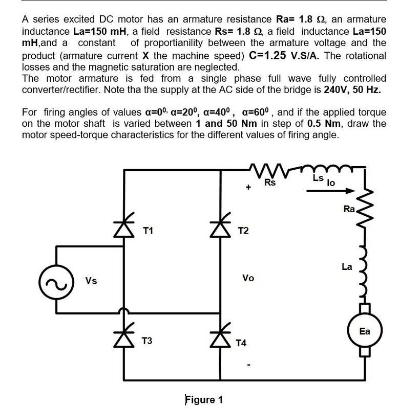

Attached below.

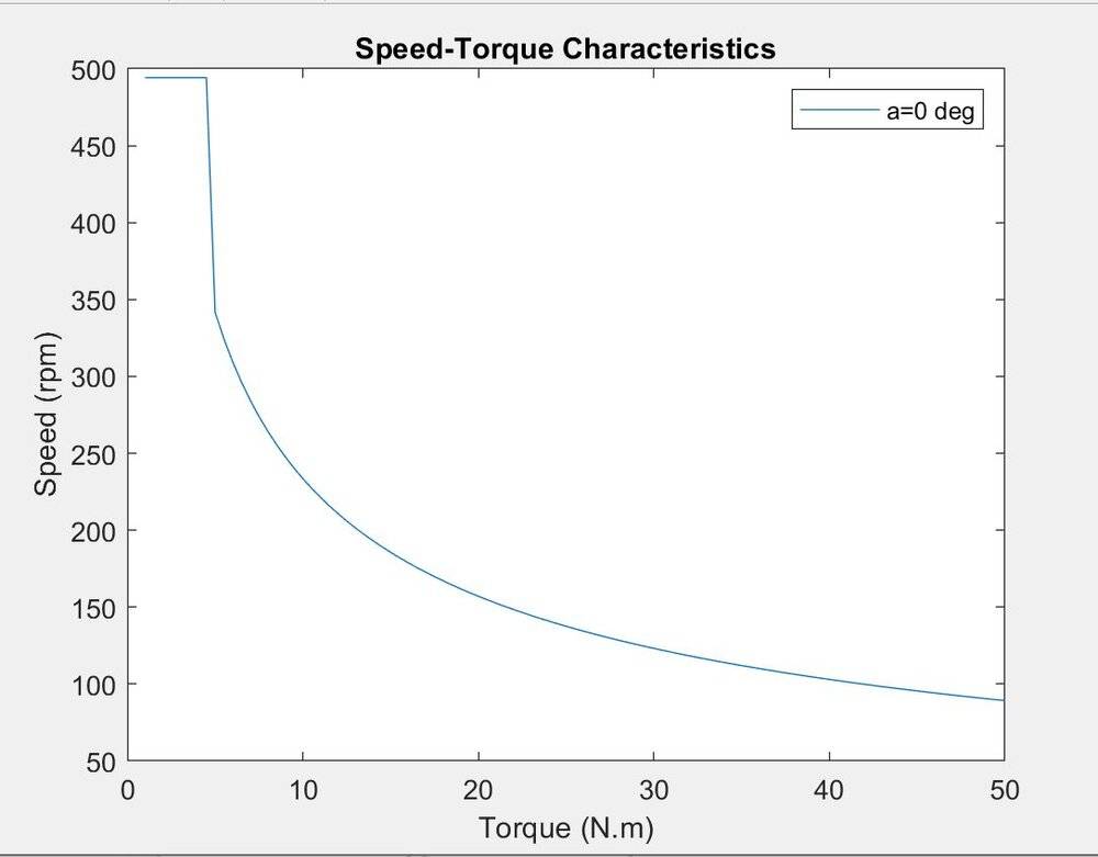

I got a wrong result, I attached it below.
Could someone let me know where is my mistake please?

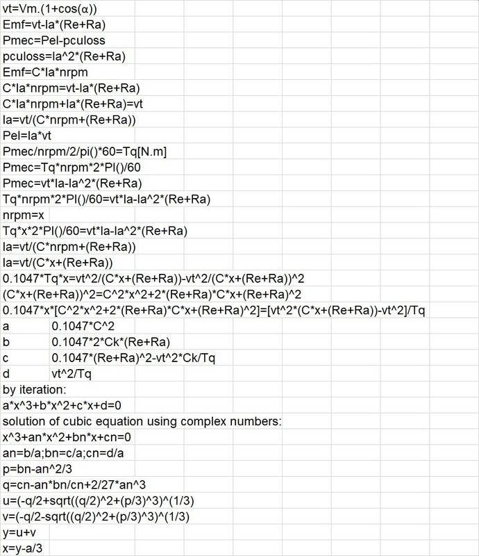

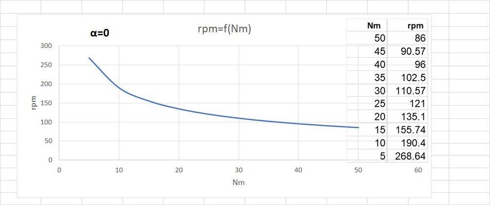

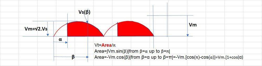

In my opinion vt it has to be average Vo(t). In this case vt=Vm*[1+cos(α)].
According to my calculation for α=0 rpm=311.9 and torque=3.6 Nm; for α=30 rpm=180 and torque=9.28Nm; α=60 rpm=69.6 and torque=38.2 Nm
If α<=60o[1.045 rad] the non-conduction time it is α /(2.π.50)=0.0033 sec.
[if T=(0.3/3.6)=0.0833 sec] Ia=1.9.e^(-t/T)=1.8262 A
If I remember correctly, the calculation formulas for DC motors are as follows:
