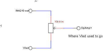

Hi Svein,
thanks for your fast reply, so how can i add the INA210 in my circuit into for the circuit to be functional as required?

Start with your first circuit. This has VLED as a feedback - when it increases, it is regulated down. If you look at the output of INA210, you have the same polarity - when the output increases, you want VLED to go down. Thus - sum VLED and the output of INA210 using a resistor in series with each. Experiment with the relation between the resistors. Or - insert a 10k potentiometer with VLED and the output of INA210 at each end and the slider to the op-amp input.

Hi Svein, thank but i don't get it.
please can you just give me a rough sketch of what you mean?

Like this. Use your first circuit, add the INA210 and connect the output as shown here.

thank you for your response, but i believe adding a 10K in the circuit also increase power loss thereby reducing the overall efficiency of my design (correct me if I am wrong).
I wish to have a design with high efficiency.

Hubert Tchio said:thank you for your response, but i believe adding a 10K in the circuit also increase power loss thereby reducing the overall efficiency of my design (correct me if I am wrong).
- The regulator system tends to minimize the voltage across the potentiometer.
- Even with a voltage of 1V across the potentiometer, the current through it is negligible compared to the power draw of the rest of your circuit.

@Svein,
thank you so much, your idea works perfectly and the problem is solved.
My second problem is still without a solution. Can anyone help?

At 25°C = 298°K, the reference voltage of the LM334 is effectively 67.7mV.
For 1uA / °K, R = 67.7mV / 298uA = 227 ohms.
The two LM334s and the zero tempco diode should all be kept at the LED heatsink temperature, calibration then only requires adjustment of the temp sensor resistor to match the reference current at 95°C. The choice of 1uA / °K is arbitrary, but is probably sufficient.
A temperature of 10°C over the balance point at 95°C must fake the equivalent of 1A LED current. The INA210 has a gain of 200. If your LED current sense resistor is still 0R025 then 1A will give 0.025 * 200 = 5.0V which is too close to the rails. I would make it closer to 2.5V where the LM334s will be balanced when needed. You need to halve the sense resistor or change to the INA214 which has a gain of 100. Anyhow, back to the value of R. 10uA must drop 2.5V so R = 2.5 / 10uA = 250k.
Hubert Tchio
- 38
- 0
@Baluncore
Thank you so much, here is an update.
I hope i get it this time around. Have a great evening.
Best regards
Hubert
Best regards
Hubert
Baluncore
- 16,668
- 10,331
(A). You need the current summing node of the circuit to be away from the supply rails so as to give the LM334 some operating voltage. That is why I suggest 2.5V. The lower LM334 is in series with a diode so it requires about 1.5V to operate. The current summing diode gives a little more headroom by moving the voltage of the summing node up. Maybe use two or three signal diodes in series to raise the LM334 voltage? The current summing node is only important while operating in balance. Your Rsense 0R004 is a very low resistance to use as a shunt. It will need to be an expensive 4 terminal resistor so as to separate the effects of resistance in the main current terminals. You could make your own 0R004 by soldering two voltage taps onto a shunt wire. I would use Rsense = 0R0125.
(B). That is better, but you will adjust the value to trim the system to cut-off at 105°C once it is built.
( C). Close enough. Any variation in the individual circuit will be canceled by the adjustment as in (B). It does not really matter if ILED cuts off over a range of 5°C or 15°C, so long as the final shut-down occurs at or below 105°C.
(D). Correct logic, questionable current summing reference voltage.
(E). Summing up the current difference.
You have drawn your “two terminal zero tempco circuit” upside down.
I would use 1N4148 signal diodes. 1N4001 power diodes are not a good choice for either diode in that circuit as it may have a few uA of temperature variable leakage and a lower forward voltage. Also ask yourself why the ti datasheet shows a 1N457 signal diode in the zero tempco circuit example. You need to use a diode with low reverse leakage for the 95°C current polarity switch, it will be in a regulated temperature environment.
Hubert Tchio
- 38
- 0
@Baluncore
I am completely confused. I don't get a bit of it anymore.
I started my design with 0R0250 but was not working until I had to regulate Rsense to 4m ohm. I have tried to change Rsense to 0R0125 or more but my signals are unstable.
I don't undestand what type of current summing node you mean.
here attached is my design, i don't know you can if you can do something on it.
The thermal design is not working.
Thanks in advance
Hubert
Thanks in advance
Hubert
Baluncore
- 16,668
- 10,331
What are manufacturer and part numbers for U61, U62, X2, D1, D2 ?
What is frequency, amplitude and offset of the “Triangle” input to U62 ?
Hubert Tchio
- 38
- 0
U61 and U61 are LMH6622 from TI
D1 is LUW_HWQP LED from OSRAM
D2 is a normal doide from Pspice
Vramp = 1.8V (3.5V - 1.7V) with 455KHz frequency
Hubert Tchio
- 38
- 0
sorry U61 and U62 are the same. Vramp = Triangle
Baluncore
- 16,668
- 10,331
Attached is the switch, LED current sense and temperature protection sections only. The output will be 2.5V when operating correctly. The LM334 model used has an error, so ignore my resistor value detail in setting my over temperature protection currents.
I will try to get the rest of your circuit into the model later but I'm very busy today.
