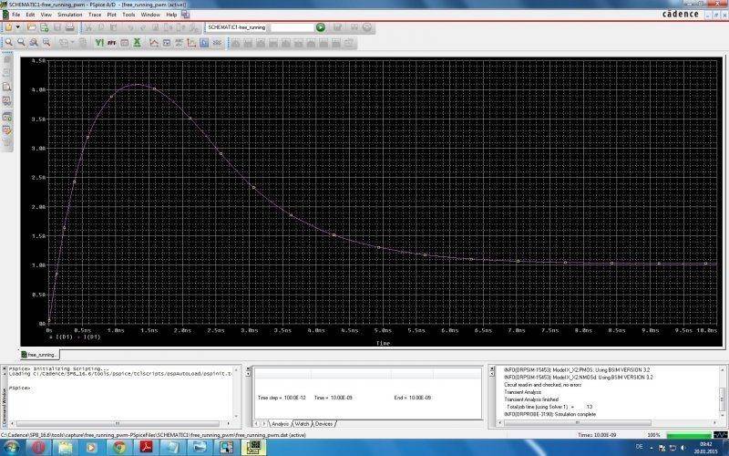

I am trying to build a buck converter without the use of any IC. I want to drive a single LED. Here are some calculated data: Vin =5V, Vout =3.225V, Duty circle = 0.651, L=6.8micro Henri, Switching frequency = 1.4Mhz, Desired current is 1A, I also assume ripple current of 0.3+ desired Current. I am using 2 Mosfet to reduce power loss.
(Source of information: http://simonthenerd.com/files/smps/SMPSBuckDesign_031809.pdf )
I have built the circuit with some components from Texas Instruments (The design is done with Pspice), everything seems to be ok. But this brings me to my first question, how can I determine the minimum PWM frequency from my calculated switching frequency? Because I will have to design a PWM generator for powering the Mosfets.
I understand, since my load (LED’s resistance) is constant changing the voltage means changing the current (ohm’s law). I therefore want to control the current by adjusting the pulse width of the PWM. For this I want to use a PID controller. How can I do this? Can someone help me please?

By the way I tested your design, but i don't understand why at the beginning the current is too large before remaining constant. Is there a way to avoid this?

Thanks once more for your support, i have tried to follow all what you said instead i get worse results. current remains at 0A.
From the datasheet of 555, pin 7 should not be connected for the case of schmitt trigger. I don't understand when you said "input to the 555 floating"

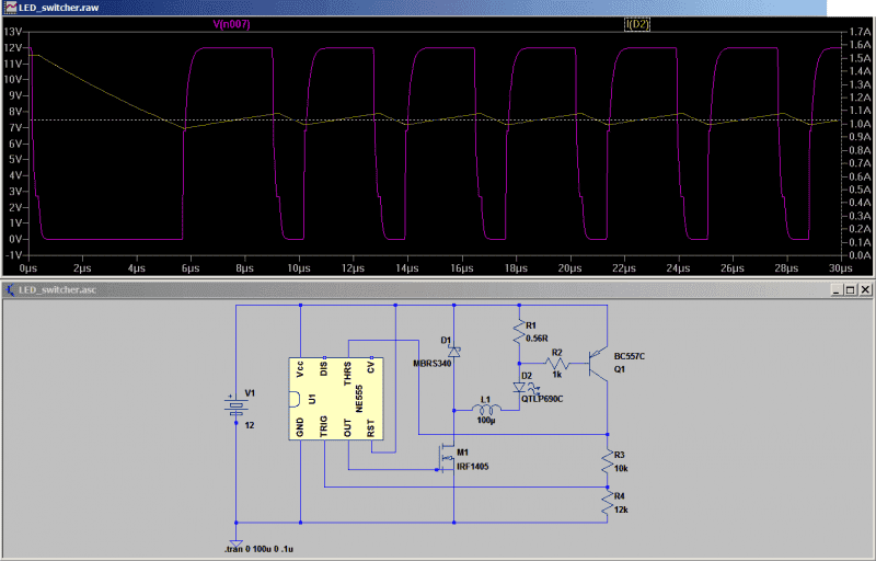

When initially turned on, LED current is zero. Q2 is off R3 pulls pins 2&6 down, output goes high, mosfet turns on, current through R1 – D1 – L1 – X2 rises until voltage drop across R1 passes 0.6? volt when Q2 turns on and pulls pins 2&6 high, output goes low, X2 turns off. LED current free-wheels through L1 – D2 – R1 – LED until it falls below threshold and X2 turns on again.

thanks for your reply, i was sick and could not do anything. I just tested the circuit but the LED current is always zero, I have increased the supply voltage but nothing happens. I was expecting some PWM at the output of the IC555 but I have a constant voltage! is that right?

The output should be switching. Are you simulating this or have you built it out of real components?
If the 555 output stays low, the N'chan FET is off and there will be no LED current.
If there is no LED current then there will be no voltage across the 0R56 current sense resistor. So the PNP transistor will be off.
The voltager on the input pins 2&6 of the 555 will therefore be pulled low by the bottom resistor.
The 555 schmitt-trigger is inverting so the 555 output should go high and turn on the N'chan FET.
That is a contradiction. When you identify where the logic fails you will have found the problem.
Follow the signal around the circuit. What is the voltage on input pins 2&6 of the 555 ?
Your MOSFET appears to be P'chan. It should be N'chan. What part number have you used?
Your 555 pin numbers should be anticlockwise viewed from above chip. Have you reversed pins 5 to 8?
With the notch on the left, pin 1 and pin 8 should be on the LHS of the chip when you read the part number.
Attached is an LTspice simulation. I used 12V supply to suit any MOSFET gate threshold.

To run on a 5V supply you must use a LED with a lower forward voltage. I changed to an LXK2-PW14 which is available in LTspice. It now works at 5v.
